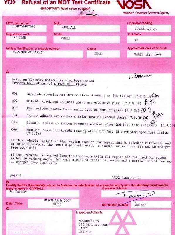

Thanks for your responses and your confidence in my ability to fix it myself!  All moral support is much appreciated!
I have had a peek at the exhaust tonight - at the cats the two flanges "simply" bolt together but look VERY corroded :(.  However, I reckon that I can simply hacksaw these off and use new bolts as already suggested :).  I generally use Plus Gas in these situations and I will give all bolts a few liberal soakings first.  So, the exhaust, on the face of it, does not look too bad.  I will do a how to when I change it. :)
However, here is the failure sheet.  You already know about the exhaust.
What do they mean by "Nearside steering arm has relative movement at it's fixings"?  Does this mean the bushes or that the arm itself is worn?
Track rod end ball joint - hopefully this will be a case of releasing the old joint and replacing with new - I just hope that the thing is not riveted to the bottom suspension arm like it was on my old Astra.
The other thing that worries me is the "Lambda reading outside specified limits" - I hope that this is simply caused by the exhaust not being sealed.
What do you knowledgeable people reckon?
Have a look at the prices written next to the failure items.  £192 for a ball joint to be replaced, £144 for the steering arm and £500 for the exhaust!

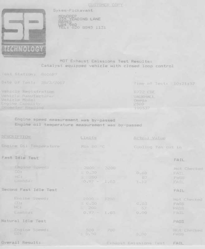

For interest, I also attach the emissions failure sheet (which I hope you can read OK).

well regarding the track rod end, a complete replacement track rod is about £36 from vauxcentre - fleabay link here - the advantage with replacing the entire rod is that you can make the replacement the same length as the original. Still a good idea to get the tracking checked though ...
a scissor-type splitter which makes removal laughably easy is about £15-20.
... so that's about £140 saved already ...
the second fast idle test shows a lambda sensor reading of zero - I'd therefore think it's a fault with the lambda sensor or its' wiring ...

Looking at the emissions sheet in detail, the Lambda failed on both tests, the first one had a value of 1.12 whilst the second was 0.00.
So, another question.  What is the Lambda reading?  Is this a measurement as to how the sensor, or on the V6, sensors are switching and if so, how can the emissions tester possibly know this?  Looks like I am going to be bu**ered on the emissions after the new exhaust goes on then.  I will check the wiring to the sensors though.

My understanding of the lambda sensor is that it measures the amount of oxygen (related to the amount of unburnt fuel as that goes into the cylinder with the air) in the exhaust gas and therefore allows the ECU to calculate how complete the burn is and accordingly adjust much fuel to inject?
I may be waayyyyy out though of course!!
I'd expect a leaking exhaust to affect the reading adversely but not to make it disappear completely!

Idler is an easy job, this seller looks fine - price is right. Rest as said is easy enough, complete track rod, change exhaust. Then do air filter before going back. Try to give it a goodhiding on the way to get those emmisions down. All in about £300, one saturday morning and a new MoT. Then relish in the £600+ you will have saved!
