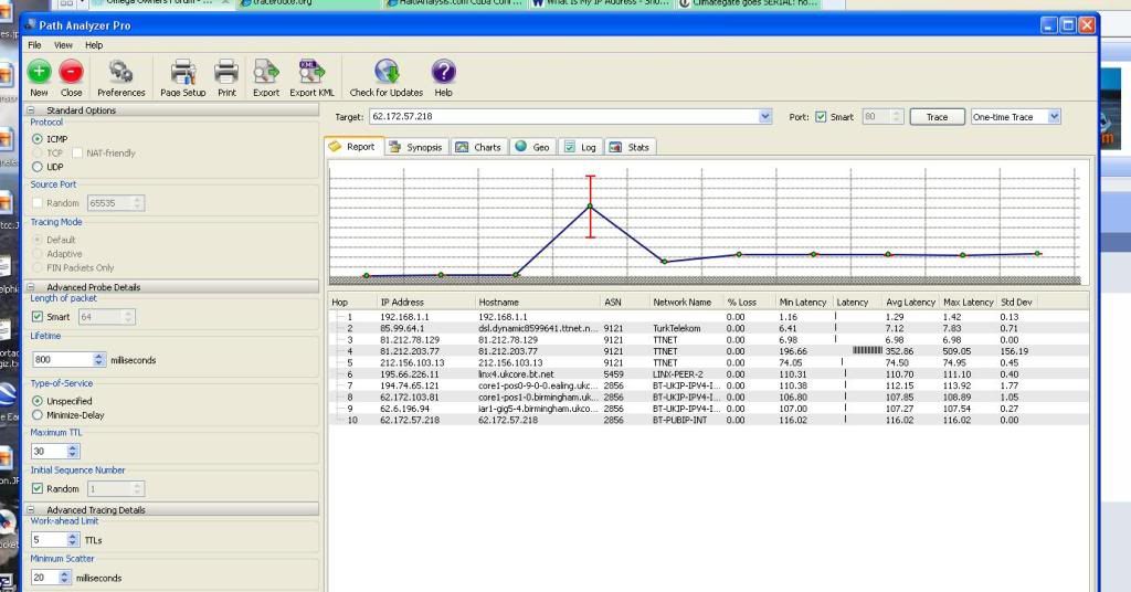

Sorry for being so long... but latest attempts ...
Factory reset of router - No difference at all
Connect router to computer via ethernet cable - No difference at all
Connect Computer via USB tethering to phone - works perfectly
Connect laptop via USB tethering to phone - works perfectly
Connect laptop via phone Wi-Fi hotspot - works slowly but OK
Connect computer via phone wifi hotspot - get asked to supply a certificate all the time when trying to set up WPA (TKIP) which is what the phone is set to.
Move the whole caboodle to the front door and plug directly into the main BT socket - no difference
Seems to me the only things left are the router itself or the line.
About to phone Dave to borrow a router .. :)
Any more ideas gratefully accepted. I can't even do a "proper" search for an alternate ISP at the moment as half the sites I try I can't get to !!
p******off Disgruntled of Wiltshire.
« Last Edit: 30 January 2011, 14:24:16 by entwood »

Entwood , lastly you can make a test
with "Remote Traceroute Tools"
try back tracerouting your ip from australia , russia etc
but it seems to me that there are some firewalls or special setting at BT that stop trace route.
http://www.traceroute.org/#United%20Kingdom
there are many country sites that provide back trace..
you can get your ip from
http://www.whatismyip.com/
also a network analysing tool (trial for 10 days)
gives good info
you can download from here (if you can reach :-/)
http://www.pathanalyzer.com/download.opp
« Last Edit: 30 January 2011, 14:50:18 by cem_devecioglu »
Re: Internet problems
« Reply #44 on: 30 January 2011, 15:00:02 »
Thanks Cem .. downloading now .. :)
