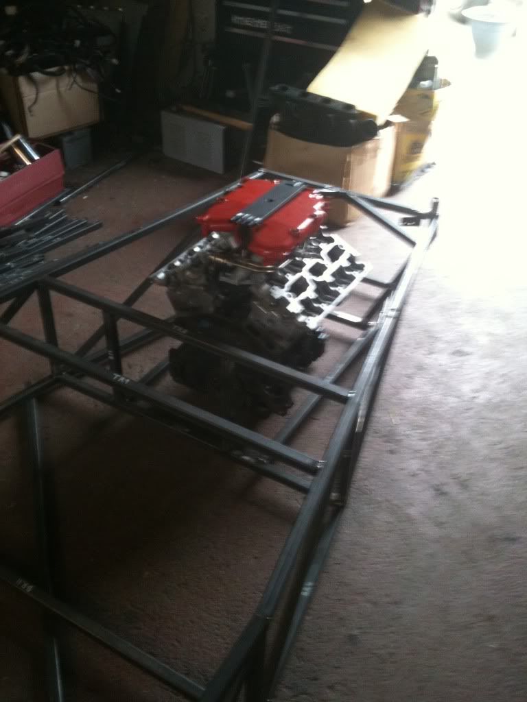

howdoo! thought id share some pics and what not for those who like kit cars ;)
its "going to be a Haynes roadster" with a big twist
it'll have :
engine: x30xe (ported heads, custom manifolds to come out of the side of the bonnet :P
omega box r28
and all the usual sierra running gear
lightened flywheel c20xe using the xe cover and a c20let friction plate, weighing 6kg complete!
oh and a custom made prop.
should be rather quick!
and in the long run "id like to" run mega-squirt with throttle bodies
 but i have to Iva it first ;)

Interesting project. Much respect for welding up the chassis rather than cheating like I did and buying one from Westfield. Looks like you've done a nice job too. :y
I take it the engine'll be a little lower in the final fitting. Forward visibility might be an issue as it stands? ;)

as for view i think a rather large bulge is in place! but yeah the chassis its self is nearly all welded just plates and suspension brackets to put on along with steering support and rear frame work.

You could always ditch the plenum in favour of some downdraught throttle bodies to make it a little less tall.

well if you see on my first post i do mention "eventually" using throttle bodies with a stand alone system :P
but never thought it would look that good!!!
for times being though im using a vectra msd top  :)

just my opinion,
this engine too heavy and strong for that chasis..
dont know what type of welding you did, but they will be the first point to risk your life , if one of them decides to give up :-/

that's fair for you to think that , but don't worry i assure you and most importantly myself! that im sure my coded welding speaks for itself and that others have put big v8s and other v6 setups and there fine. you'll be surprised in just how strong theses chassis's actually are :P
a general rule of thumb obviously if the welder is good is that 1 inch of weld can usually take around a ton, so if you imaging all 50/60 welds on my car not including the extra long seam welds on some bits that it can take a goo beating :P

 oh Kevin in regards to what you said earlier about height
if you see pic above (tr8+tr9) the scuttle sits on that and that is roughly the same height as the top of the omega plenum so it should work out just nicely :)
