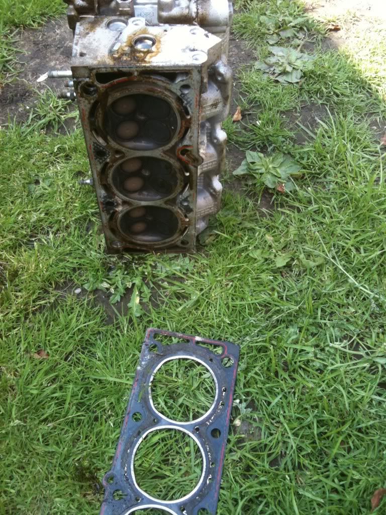

howdoo all! some big progress lately got most of my brackets done and some other nit bits :)
but  I now have an engine!! its a x25xe from a vectra but i got it off ebay with gearbox loom starter motor dual mass flywheel and clutch for 60 pounds!!! whatta bargain!!
anyhoo to the pics!!!
That was difficult to get in! and even more getting out!
i have some big development plans for the engine " so he says"
im going to be fully stripping the engine , porting the heads and doing some polyquad experiments to the inlet valves. as said earlier in the post i think i may be going with the megasquirt option :)  as all the mods i plan to do , the ecu may not like even it being a maf!
and also that way i can cream even more power from it :P
Michael

Bet you were super cautious on the brakes driving home! :o
One small mishap and that would have been curtains! :o
GL with your build.

Good progress, keep us updated with photos  :y
Make sure you check the cambelt history  ;D

wouldnt have bothered with the 2.5 tbh. you will spend a lot of money to get the power output up to the same as a standard 3.0/3.2. Imo the 3.2 would be the one to go for - much better exhaust manifolds, programmeable ECU....... ;)
* I may have missed something, as the chassis apparently had a 3.0 in it at the top of the thread, but the last post mentions a 2.5 ? :-/
