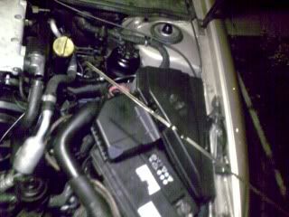

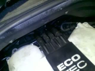

Here is whats left of the oil and coolant under the air filter/expansion tank

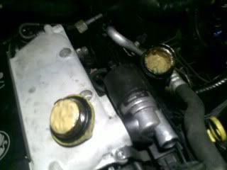

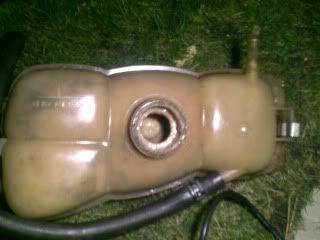

The expansion tank:
Looks like a really careful mechanic has been at this  :o :
Filler cap, could be normal:
But this is a good sign:

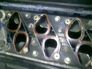

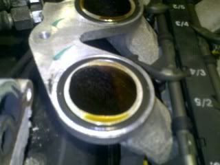

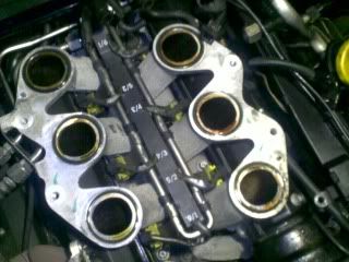

Taking the plenum off, I found a lot of oil residue in the oil and in the intake manifold:
Here is what I mean:

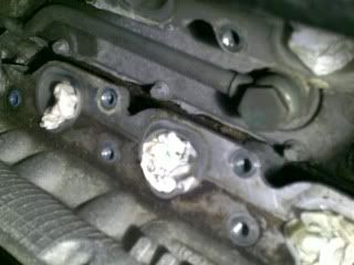

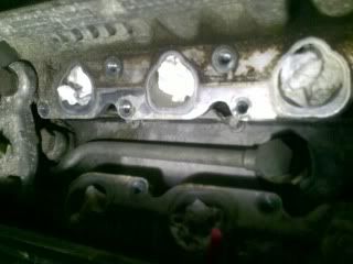

Yet further down in to the V the plot thickens.  The heads are clear, very strange.....  :-/ Also it would seem that someone decided to use thread lock when putting it all back together once in the past :o  Nearly broke my wrist taking these bolts off:

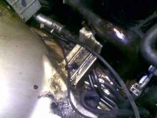

Well the newish sealant would point to the oil cooler plate at least has been replaced at some point in the past, but not recently by the looks of things:
So tomorrow the truth will out when I get the oil cooler out of there.  If it's just that I have paid £165 plus oil cooler parts for a really nice miggy :y  (fingers crossed)

Right oil cooler is out and yuk!  What a mess.  Defo the oil cooler now, it was sitting in brown mayo when I took it out.
So just waiting on parts and some traffic film remover from Machine Mart and she'll be back on the road in no time :y
