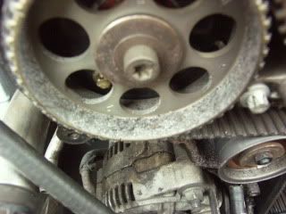

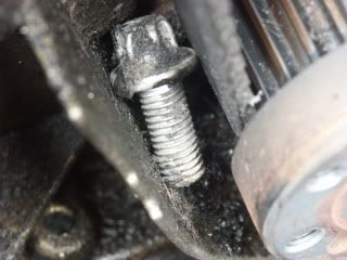

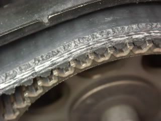

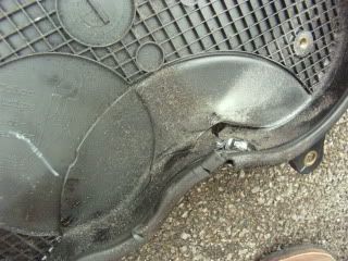

Just spent the last 7 hours doing what was supposed to be a simple cambelt change.  Ok, a small portion of that was a slight schoolboy error on my part but look at what was found:
Also the plenun O rings and EGR manifold have been sealed with instant gasket so spent some time getting that off and cleaned.  Finished off with the breathers and the ICv cleaned.  Car now runs sweet  :y
I am not going to say which user this car belongs to but I spent a long time sorting out problems caused by shoddy mechanics, supposedly professionals.  He got the car off someone on here but they didn't do this work, we worked out it was a garage at the time of 3 owners ago.  I will try and find out which garage it is and warn others on here never to go there, it's in Wales I think.
Just goes to show that if you aren't sure about the cambelt from the history then get it done.  I think from now on I will be checking cambelts on all omegas I purchase....
Anyway, now on to my car  ;D

Those bolts give me nightmares Gaffers!! :o :o :o :o
The number I have manage to drop when working on the top end of the engine :'( :'( :'( :'(  Still I have always made an effort to recover everyone, and your picture clearly shows why!! ::) ::) ::)  You obviously have just managed to stop a potential disaster taking place with that one.

It was not mine but someone else on here.  He was assured that the cambelt had been done, which I think it had but what a job.  I think a spare bolt was used in place of the wedge and then forgotten about and they obviously forgot to remove the aux belt tensionner thus snapping the case.  Either the case or the bolt had started to shred the belt but the car has done a lot of miles since the belt was last changed (less than 40k though)
The owner had heard some whining inside the cambelt cover and was not convinced it had been changed.  Good job he didn't just ignore it.
