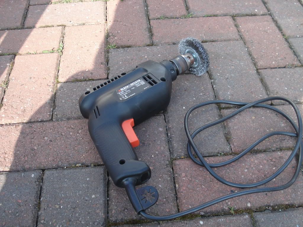

so i grinded it out using a new wire wheel drill bit bought from b&q for £8 (bosch):
nb, i went to halfords to have the paint mixed up, gave him my colour code and he said it was just star silver which was on the shelf. £10 saving. good start!
tried grinding rust with my cordless drill. the amount of power i needed though just drained the battery and wasnt really touching the rust..... so i employed the use of 'Mr BIG':
had this hammer drill for years and its so powerful it did the job a treat  :y

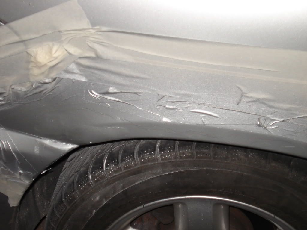

completely covered the area with filler. i wasnt p*ssing about. i then set about sanding the area with my power sander. used really rough sand paper to start and then once id shaped i  got the real fine paper and was left with a lovely result (i think lol)
primer, paint and laqour later im left with the below:
note that folds are just masking tape and i did cover the wheels before painting. its just dust from sanding the filler  ::)
well this time its gone real well.... except it got dark so i will see the final un-taped end product tomorrow morning.

Not prepared properly mate - can see the filler and underlying paint edges (not feathered), plus you've lost the shape on bumper.  Your masking is too close to the painted area and you will now have a distinct line when you remove masking - you should really give it more space and end up with a bit of overspray which will easily polish out.
My comments are meant to be helpful mate so please don't take them the wrong way.  :y

when you say the  masking tape is to close, do you mean that i should have put the concentration of the paint on the affected area and ''blended'' it by lightly dusting the surrounding area with spray?  :) :) :) :)

Webby, the bumper only takes a few minutes to remove & would have made life a LOT simpler! Unfortunately,now you've damaged the end profile & it's unlikely you will get it back the way it was  :-/ In future mate, always remove any trim etc in the 'danger zone' . As said already, not being critical, just trying to help  :y ;)

bearing in mind i have the distinct line (after removing the tape) surely i can now still feather the paint though?  :-/

Hi webby, just looking at your pics, did you use just filler in that hole or is the first fill bridge a gap(red filler with fibreglass strands in). Reason for asking is because ordinary body filler is porous so absorbs moisture , the bridge a gap is waterproof so would seal the back of the hole so preventing the bubbling up that happens after a few weeks.
As the others have said you need the masking further away from the repair and don't paint up to the tape edge, spray on the basecoat then when you apply the laquer go a little further out so that when you cut back afterwards you are only rubbing the laquer and not the base colour which will avoid the masking line thatyou have at the moment.
Really sorry if it sounds like I am going on and on but just trying to help as I used to do some of this for a job a long time ago :y

The numbers with isopon are p38 and p40 but I forget which number is filler and which is glass fibre reinforced filler,someone will be along in a minute who knows which number is which  ;D
On the upside webby it looks like you got all the rot this time but would have been easiest for you with bumper off as others have said :y
