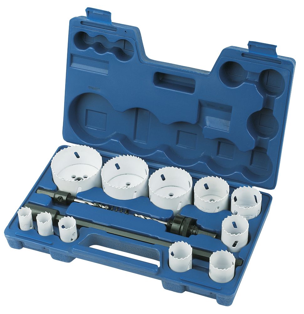

I bought one of these sets to allow me to cut largish holes.
http://www.screwfix.com/p/titan-holesaw-set-15-pc/93131
As mentioned above a holesaw needs a good pilot hole otherwise it will snatch when it breaks through. If I was cutting a hole in flat sheet I would clamp it to a block of wood to give the pilot drill something to bite into. Not sure if that would work with a curved/painted body panel though :-/
