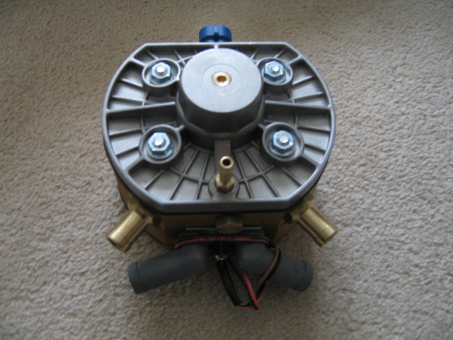

Here is the evaporator
Looking again, would I be right in saying that the grey pipes are coolant (does it have an IN and an OUT, or does it not matter), the larger brass pipes are LPG out (1 per bank?), and the top brass is LPG in (or is that the vac?).

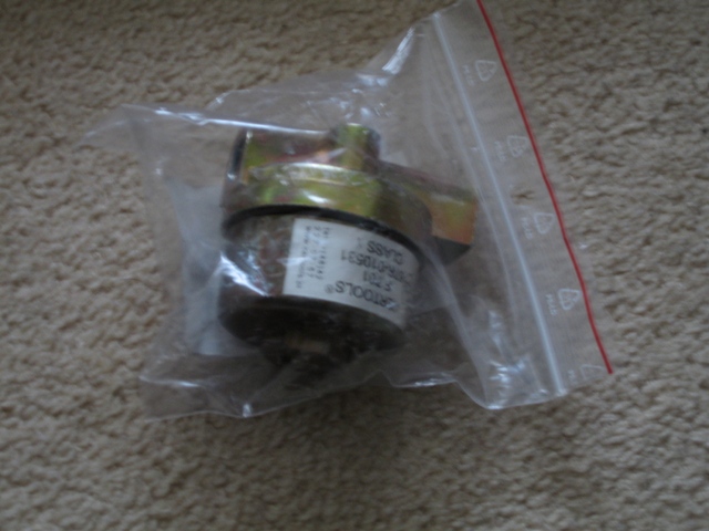

It came with what looks like a filter

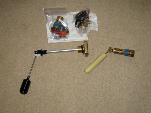

I guess one on the right is the filler (as it has a hole in it ;D, one on left is gauge/sensor (no holes in it ;D), and top is the solenoid? If its 4 hole. what blocks the 4th hole?
Can't see the gas connections being plastic so I'd say the plastic ones are for coolant. The small brass hose barb will be vacuum reference. Can't see the liquid inlet from here.
Yep, that will connect between the fuel line and the vapouriser. Is there a solenoid on that too? Or is it built into the vapouriser?
There should be a pressure relief valve in the other hole. That's in the other plastic bag next to the solenoid. (with a red bung in it)
You should have a right-angled union on the filler to take you out of the side of the valve box, then an adaptor to go into polyflex.
EDIT: I can see the (blue) solenoid connector on the top of the vapouriser so I guess the liquid goes in near that somewhere.

Found a threaded hole on one side of vapouriser, can see solenoid through it, so that'll be the inlet for LPG. Doh ;D
The right angle piece in the bag with the suspected pressure releif piece has right size thread to go into filler.  Does the pressure relief have a pipe to take gas out of car, or is that just vented into gas box?

« Reply #3 on: 30 March 2011, 12:33:05 »
It just vents into the box, and is then taken out of the car by the ducting. :y
