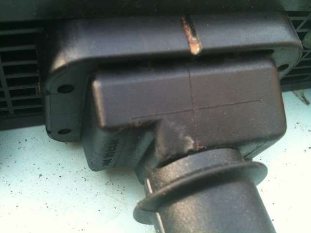

Apart for a crack and some discolouration on the coil pack, can't find anything wrong.
Put it back together, taken it for a blast, seems fine  :'(
It's going to be one of those annoying faults isn't it ::) ::)

Coil pack around pot 4...

If these are the coilpacks I sold Mr Gixer - they looked to be in very nice condition, but if it turns out that they were faulty, I will refund for them. :y
I've seen a hell of a lot worse. Not much wrong there IMO.
We could fit one off mine if it helps...  As long as it's not contagious.
We could fit it one off mine if it helps...  As long as it's not contagious.
I'll use it for work tomorrow, see if any codes popped in.
Looked at the old one I pulled up of mine last month, that really is trashed - sees out of an oil bath, the rust has expanded and cracked all over ;D
Saw it in the bench, but that what I mean, how bad was that before it missed? Its cabaged. This ones new by comparison. Although stranger things have happened of course.

discolored coil pack was only symptom of mine when it had failed.....
Doesn't look too bad but there is some evidence of what could be arcing :-/
Looks like you might need to part with some money and get a new one ::)
