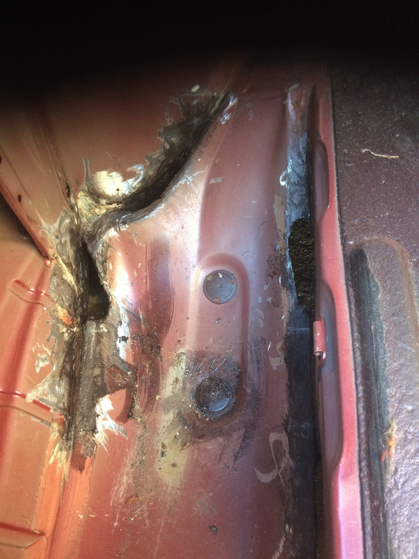

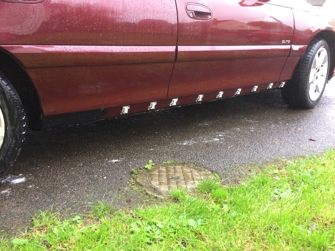

« Reply #19226 on: 12 October 2019, 18:35:06 »
After chopping the rot out of the spare wheel well, welded new metal in.
Im not the worlds neatest welder, but I think a few coats of paint, will make a welder what he aint.
As Im a half crippled old fart, I was knackered when I finished, but hope to paint it and tidy up underneath tomorrow.
Then the search goes on for any more rust to chop out. Sometimes not sure why I bother, but it has to be better than sitting indoors watching dickheads real deal and other assorted shite.

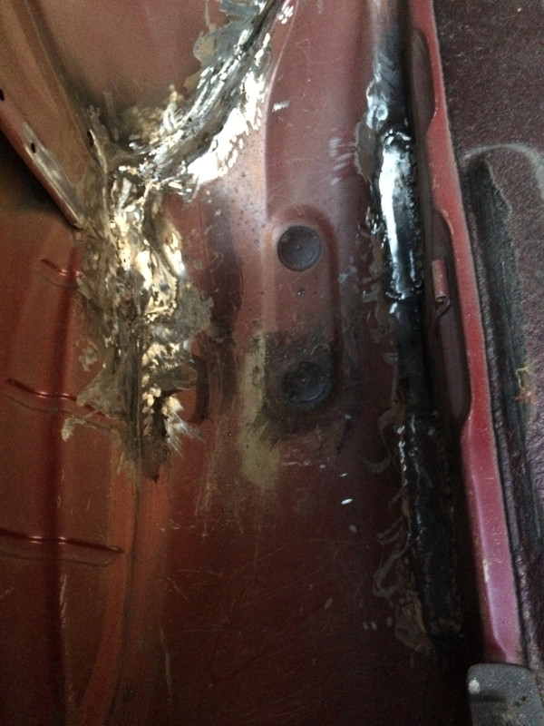

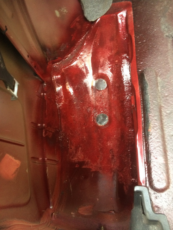

Further progress has been made.
Welded area painted, but not happy with it as I had almost run out of paint, so will probably do it again.

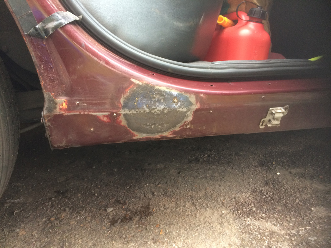

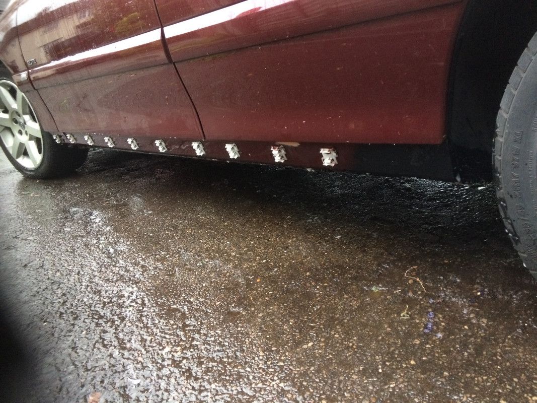

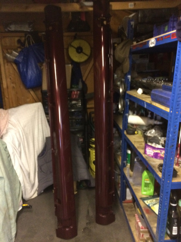

Sill covers removed. Found flaky paint and surface rust, but nothing horrific. ground surface rust off, applied Bilthamber Hydrate 80 all over, sprayed Supertrol in all the drain holes, cavities etc. Then sprayed the affected areas with stone chip.
Im pretty confident that will hold the rust back for years to come.

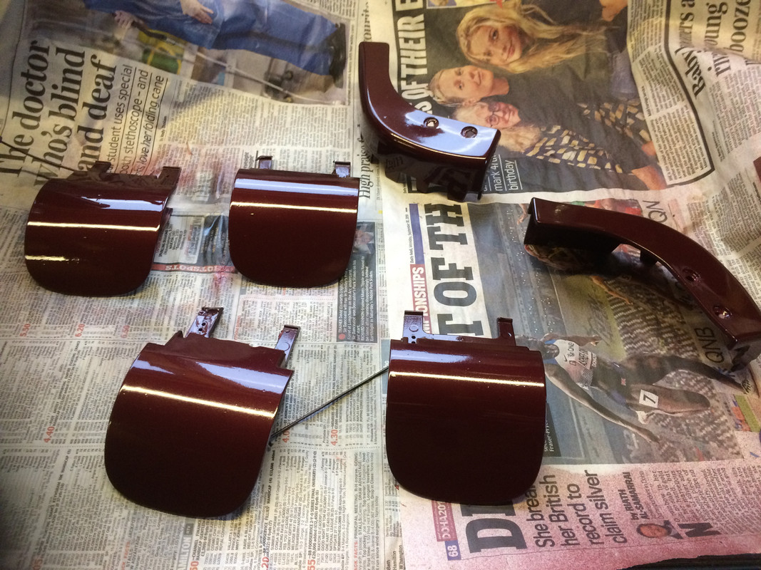

Cant refit the plastics due to rain, so decided to give them a coat of paint and a couple of coats of lacquer.
More rain predicted tomorrow and back on nights for five nights from tomorrow night, so probably this time next week before I have a chance to refit the plastics.

I;ll be taking my sill covers off again pre MOT
I did the same as you last year but will check and re-apply supertrol each year
