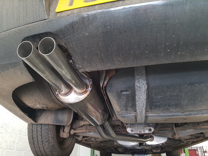

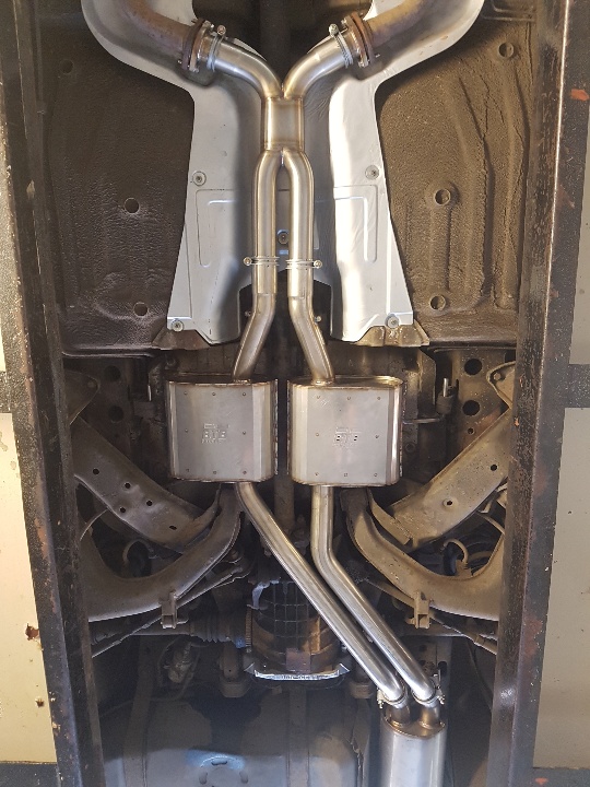

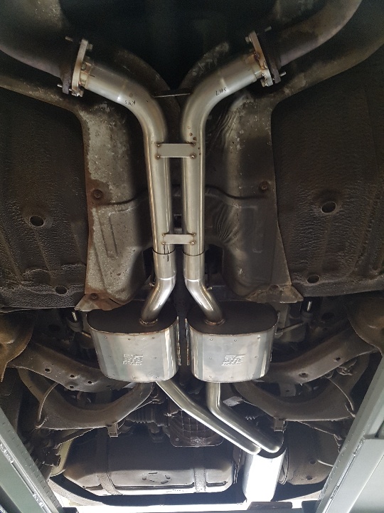

Finally got a chance to try my prototype stainless system both with and without X-pipe.  I can't really tell the difference, and both versions are so much quieter than the previous longlife system, it makes cruising at 70 (with fully functional climate working :y) a much more pleasant experience
Next job is decorative tail trims trims, and I can't decide on satin black, satin stainless, brushed or mirror polished.
There is no other chrome on the MV6 so black is probably what I'll go for.

Very nice. How much would you charge a customer for that set up?

Once they are jigged up, and with the simple twin pipe front section and no fancy tail trims they will cost around £990-£1068 depending on final materials cost.  All 1.5mm thick 304 SS and double skinned silencer boxes.  Single skinned boxes will be a bit cheaper to make but probably less refined, I haven't tried any on the Omega yet.  We also use the best internal packing materials so they don't burn out and sound tinny after a year or two like some SS systems do.  I realise it's a high price, but I already have had 2 or 3 Omega owners who want something like this which has OE sound levels.  RHD manifolds and cat downpipes are in development too...

So the exhaust will still be gleaming brightly when the rest  of  the car has rusted away.  ;D Looks good though.  :y

Looks very impressive and exceptionally well made.
Personally I would go for a pair of roll tip stainless trims at a 45 degree angle as per the original tips when the car was new. I fitted a pair I got quite cheaply off Ebay to the last aftermarket mild steel exhaust I fitted with internal spring clips to secure them, and three years on they still look good, just like original tips and you wouldn't tell them apart.
I'm sure with your capabilities, they would only take a few minutes to make!!
