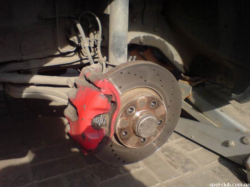

-MAV-
  • Dnipropetrovsk, Ukraine
  • Posts: 24
Re: GTO / Monaro Brakes on OMEGA / CATERA MV6
« Reply #14 on: 06 July 2007, 08:25:26 »
Thanks! thats all i wanted to know.
before 1997 4 cyl omegas  had smaller brakes than V6 ones. From 1997 all cars have largest aviable 296 mm discs and same calipers with V6.
Here is the pic of my brakes. in fact, i was wrong about that yours are different, they are the same. To be sure, i checked parts catalog :)
I got Zimmermanns when stock disks worn out. Nothing special, but i like it :)
Thanks again for useful info!
Now i know where to get more stopping power when i need it...
