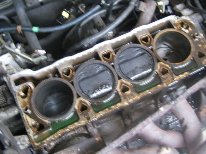

pictures aint perfect.....and head is not yet cleaned, oil in throtle body was not that bad....just something i havent seen before...

I can't see from the pics but in order to get 0 compression there must be a big hole somewhere :-/ Just like James's LPG head on his Veccy, a lump of valve was missing. I would have thought there should be something quite obvious to see :-/

Looks like number 1 cylinder has been steam cleaned to me......much cleaner than the rest of them both on the head and the block so thats a major head gasket failure.
God that K series block design is bloody awful.....no lateral support between cylinders just drop in liners.......no wonder it has problems.
Get a straight edge on the head....I bet its warped.
And i bet your right, the head gasket looked in resonable condition to me, ie not the original from a 1998 car with 100000miles on it.....

Small update on this.....whereby my powers of observation will be reprimanded by Mr DTM...
All my attention was focused on the head and valves.
Remember 0 compression on no2 and 20% reduced compression on no4. Oil from exhaust manifold on no4.
Last night whilst tidying workshop i just happened to glance at the block which is still inthe car.....
number 4 cylinder has a hole in it  ::) :o so would that explain oil and obviously low compression.
Now if thats what happens to nomber 4 with low compression what on earth will i uncover on no2 no compression !!
I have an identical block on a hoist currently so sometime / somehow i can create a complete engine from this lot...
