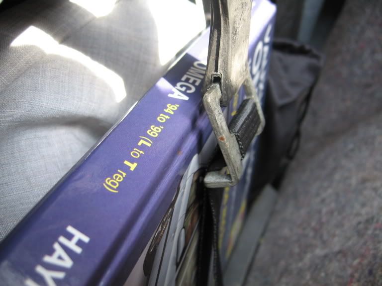

OK, dumb ass question.
How does the spare wheel restraining strap thread through the buckle on the saloon.
Not sure if its me being stupid, or a stonking hangover, but I can't get it to hold...

It pushes through the front over bottom leg, then loops from the back over the top leg then pulls against the toothed leg.

Still not quite sure I understand. Anyone got a piccy that shows it?

Push strap through top slot from back feed through bottom slot from front, pull hard, job done. Holds on mine.

I am glad that you have asked this question as I cannot figure it out either!  ;D
Got the spare on at the moment and need to replace a tyre on one of the alloys owing to a bl***y builders screw on the road >:(
Should I start a thread "which tyre is best for my omega"? ;D
If anyone has a pic of the strap done up correctly, that would be great.

Cheers guys, sorted!
Piccy to follow....

Fed the strap behind the serated edge, up through top hole, then through hole below, then between serated edge and strap. Pull tight.
Piccy...
