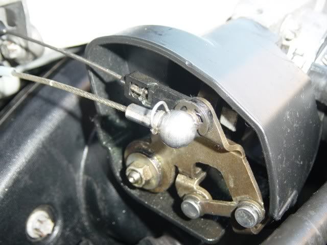

Hi Snapz.
The engine end of the throttle cables should look like this if thers cruise fitted, but the circular clip should be snapped in place.

« Reply #24 on: 18 January 2007, 13:34:00 »
Yes it has two cables.
