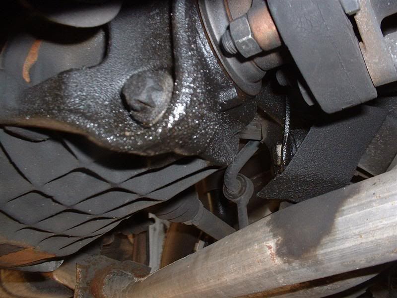

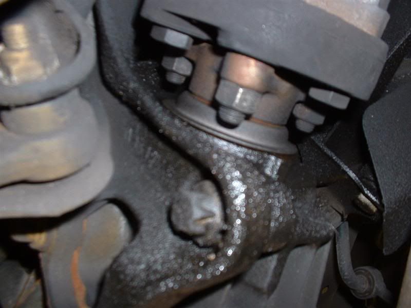

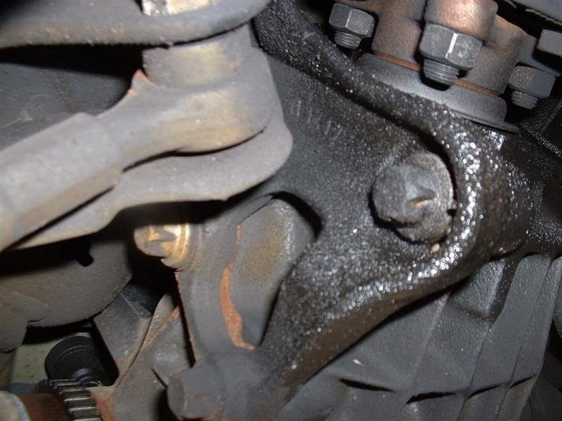

« on: 06 February 2007, 12:16:28 »
Pictures of diff taken from offside of car

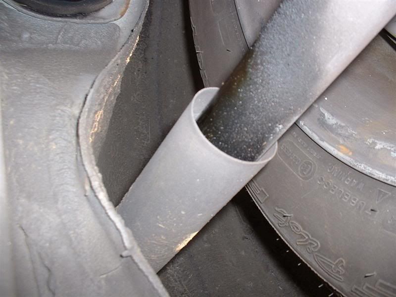

Nearside shock

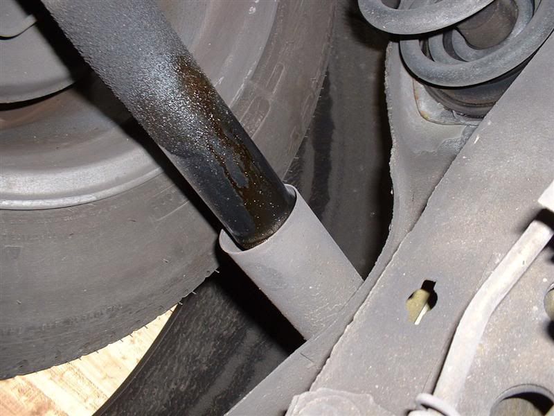

Offside shock

Looks to me like the pinion shaft seal, there will be a band of oil across the car where it is thrown by the shaft rotation....looks like some is burnt onto the exhaust.
If it was an o/p seal it tends to just be wet around the seal, it doesnt get thrown as far.
Looks like you need two shocks, that is a MoT fail, unless the oil has come from somewhere else.

A little bit of oil spreads a long way so I suspect it is still full. If it was dripping and forming a patch on your drive I would be more concerned.

The diff leak looks worse than it realy is....I suspect you would struggle to tell the level had dropped if you looked.
Surprised at the shock absorbers though!

I would do the shocks first (as said assuming the leak is indeed from the shock itself), luckily the rear ones are easier than the front ones…
As for the diff, again as said before if it is ‘sweating’ oil and not actually dripping, you should be OK for now, and at any rate it is a very rugged device and will take some beating before any permanent damage is caused… but if you intend to keep the car for the long run, it needs to be tackled at some point of time.

AA - That is exactly where my diff is leaking too!  :(
I have just copied your photo if that's ok just to indicate something on mine:
Where i have put the red circle is where it drips from, after a long run (say 1hr) and I look under the car i see a droplet of the oil at the bottom of the metal braket.
If I leave a plastic tray underneath the car, it will leak about a 5p coins worth, then stop. But it does this after every run  :'(
