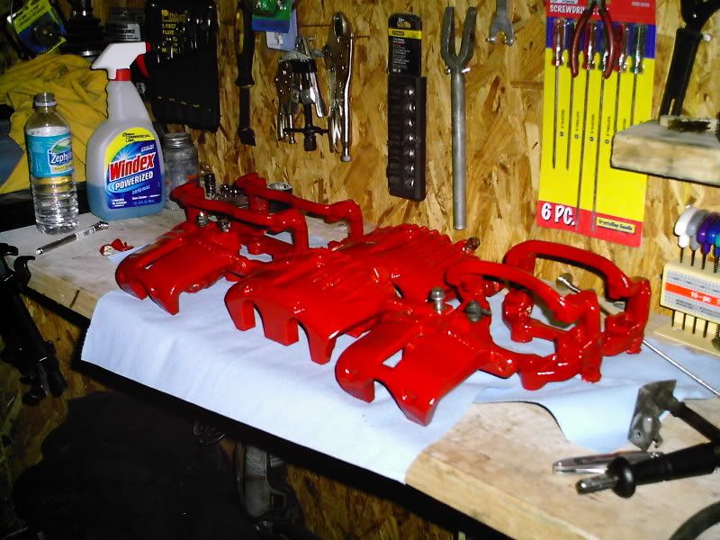

Monaro not that common here. Are the brakes much better?
According to my American sources the 2004 Pontiac GTO front brake calipers are a direct bolt-on. The 2005 and later calipers won't fit. The advantages are less unsprung weight and dual pistons for greater clamping power. I suspect the Holden/Vauxhall Monaro shares them but I can't confirm. The Catera's front discs are the same diameter and thickness as the GTO's. Below is a link to Yahoo's Catera Forum where the GTO brakes are discussed, and the only decent pictures I could find of the Catera and GTO calipers.
Yahoo Catera Owners Forum: GTO Brakes
http://autos.groups.yahoo.com/group/CateraOwners/message/21291
[size=14]Catera Brake Caliper[/size]
[size=14]GTO Brake Calipers[/size]
