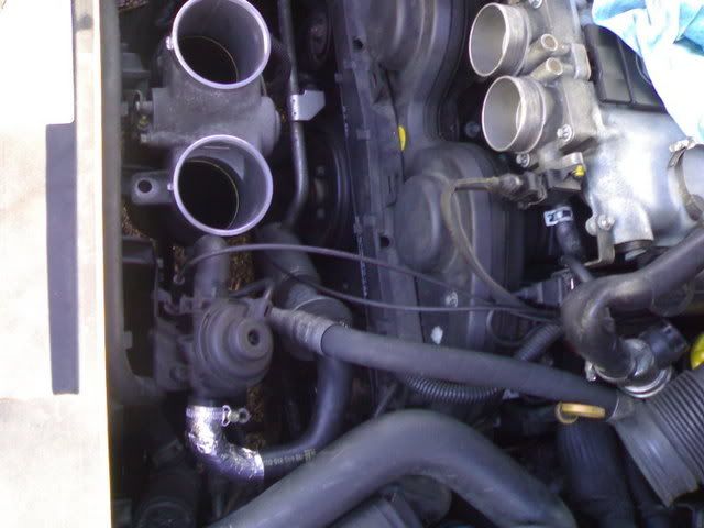

Decided to change my aux belt yesterday & noticed a split in the hose in the pic below.
I taped it up for now because Vx were closed & I didn't have any other I could use as a stop-gap.
Low end power is now back however tick-over is still low & doesn't change when I put it in gear, I still have a "flat spot" on acceleration & there's a hesitation if I floor it but things are much improved.

The pipe with the silver foil on? Thats secondary air injection.
Yep that's the one, it runs fine when cold but starts misbehaving when up to temp.
I don't suppose anyone has one of these lying around  :question

« Reply #29 on: 05 March 2007, 14:29:59 »
'Fraid not. Common Failure, often caused by fault with 1 way valve...
