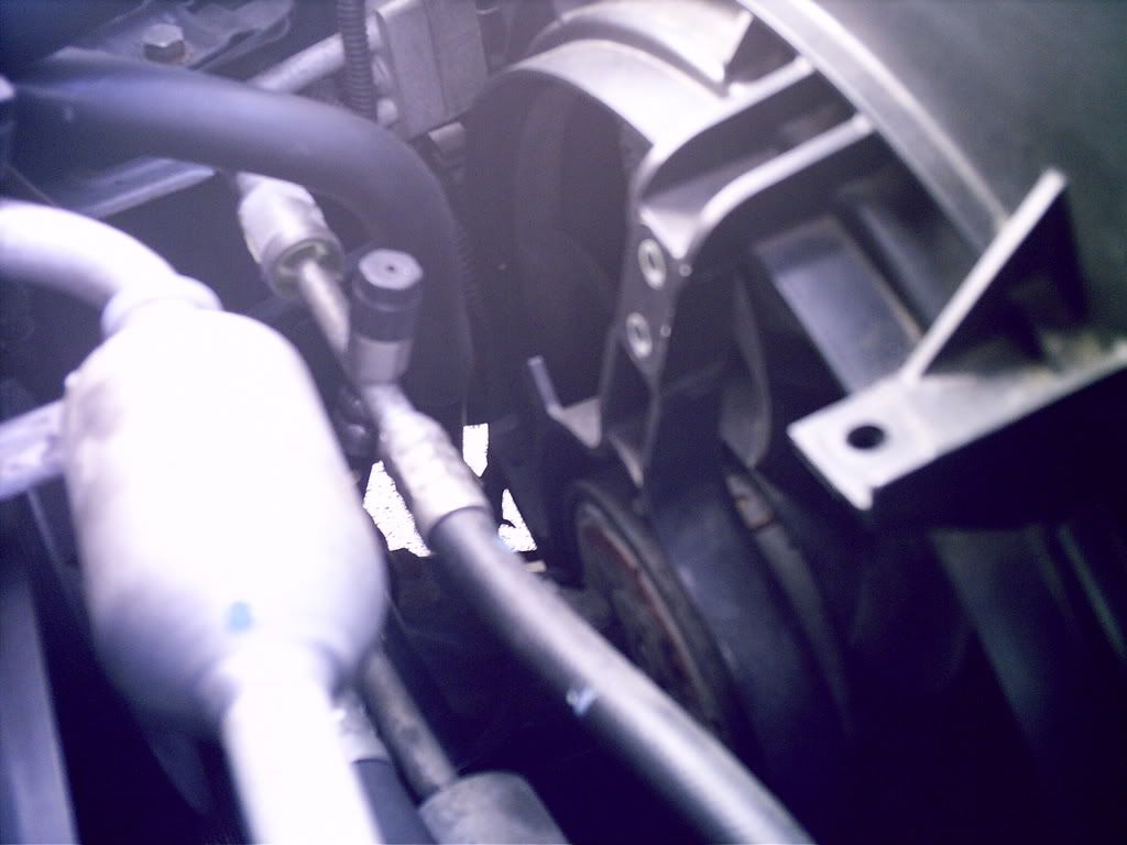

just got back from work and the car temp was 92ish but did not have to stop until I got home.   after reading on here I had a look for the fans, only found one behind the rad (see picif it works) If the thermostat was not opening wouldent it overheat on the open road? and the water in the header tank stay cold? .
I am sure that my fan only comes on when realy hot not in two stages, as mentioned, I shall have a look in haynes to see if this is correct  When I turn the air con on the one fan behind the rad comes on

Not another in front of the rad?
