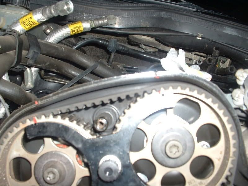

Here goes for the pics.... best I could do in the dark
The tool below is for a 2.5 but I have a 2.6 - will it make any difference or just align it to the case as the previous owner seems to have done?

Since the official procedure for the 2.6 / 3.2 calls for installing the belt at 10 deg. BTDC and just lining up the marks on the belt it's possible that it doesn't achieve such accurate cam timing. The guide rollers are not adjusted in the 2.6 / 3.2 procedure.
Gut feeling is that they won't have changed the cam sprockets so the timing tools should be accurate but not having been inside that many of these engines I wouldn't like to say for definite. You could try the "new" procedure and see how the timing looks. Does the new belt have the alignment marks on or have you got one without?
The 2.6 / 3.2 procedure is to lock up the cams at TDC position, remove tensioner roller and bottom guide roller, remove belt, replace all but lower guide roller then turn crank backwards 10 degrees, install belt and lower guide roller, lining up the timing marks on the belt with the crank pulley, noting that there'll be slack in the run past the lower guide roller to allow its' installation. Once the belt is on, turn crank to TDC, removing said slack in belt, tighten tensioner roller to 10mm past marking and turn the engine over 2 turns. Bring it back to TDC and see what the cam timing marks look like.
