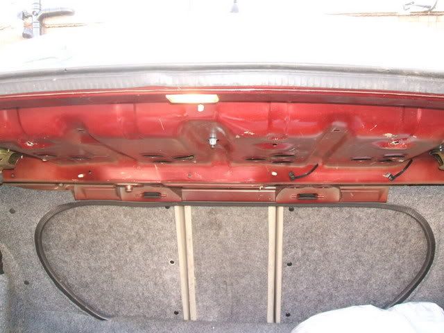

Timbuk
  • Telford
  • Posts: 3706
  • owned a Datsun 120y once!
Re: bose speakers
« Reply #14 on: 23 September 2007, 17:57:14 »
Just had this problem myself, head unit works fine but no sound, then i found this :(
not happy >:(
