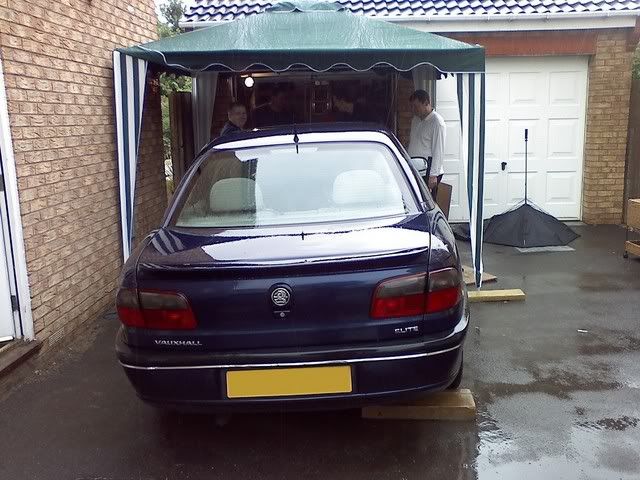

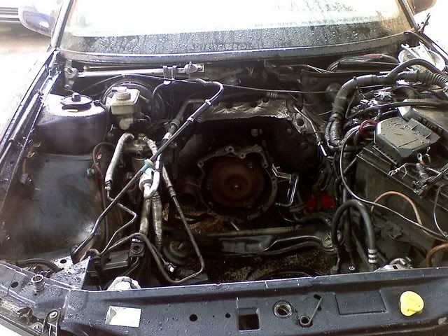

A few more pics;
Engine mod  :D
Ready for replacement
Shelter
Tunnie getting wet
