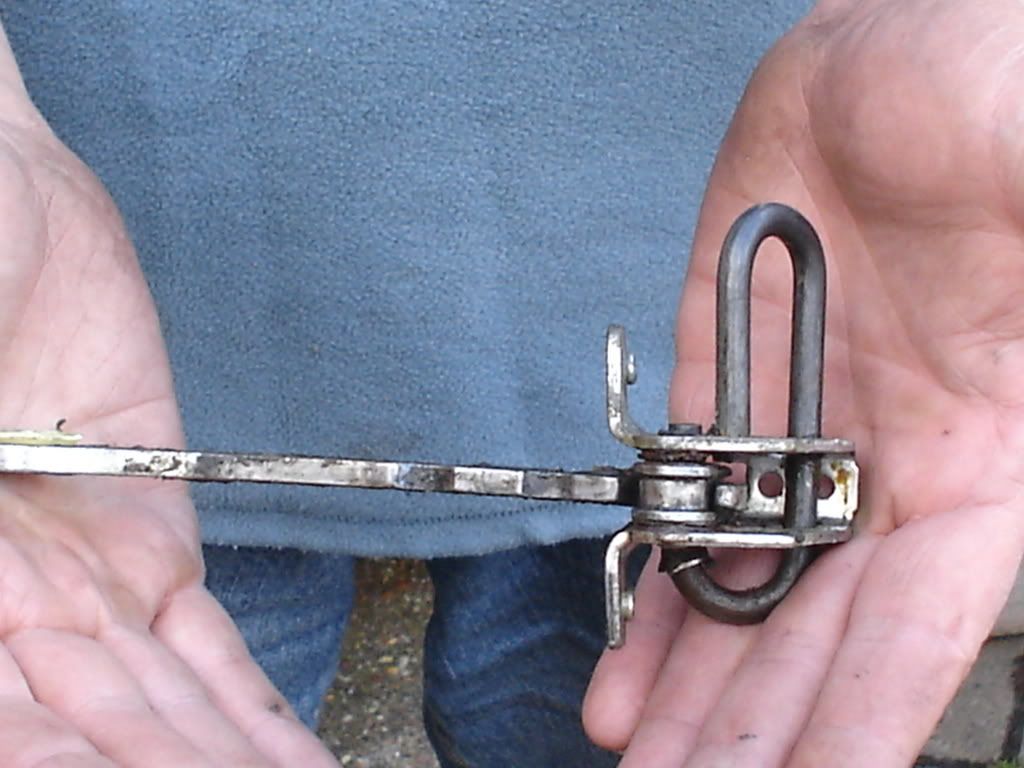

Looks like i need a new door. I watched the door bush changes at the Lakes but left it too late.
   The check strap's pulled away from inside. I wanted to keep it all original. Gutted. >:(

I have that to look forward to soon :(

There is a repair kit for that, about a fiver iirc...

Thats the bush within the roller thats fubar.
I repaired mine with a short bit of copper central heating piping inside the roller that I had in the garage.  Been almost 2 years of (drivers door) use and still sound.....
Straightforward to try it Guy, otherwise its a new checkstrap.   (and I may just be able to help out a fellow curry lover with one of them.....   :y)

 :(The checkstrap's torn through the inside of the door so does the repair kit cover this, like a big washer so to speak? I.e like plating the ripped metal with a larger plate? Have plenty of nuts/bolts etc & do'nt mind buying replacement checkstrap but want to keep original door.
    This is the first fault i've had so ca'nt complain. Taken checkstrap out for now so must remember on windy days!!! I did replace washer on passenger side while i was at it!
     Thanks to all for your help. BIG curry next year. :y

my drivers side door had hardly any metal on it at all.
The repair kit comes with two plates, it sandwhiches the damaged metal between the two.
They are both the same size, one will need to be ground down a bit in order to get it to fit in the aparture, try and keep it as large as possible as this will help to displace the force generated by the check strap.
Mines as good as new now   :y

Its likely the repair kit will still be OK ;)

If the repair kit is sold by Vauxhall for this car and repair, why the hell don,t it fit.....why does it have to be ground down???? :-/
Coz it don't fit the hole for the easiest way in....

If you check out the bottom piccy in Amigov6's link and look for the metal bush protruding from below the bracket below the roller you will see what I replaced.
That and a couple of plates either side of the door frame done the job - and a pair of slightly longer screws as well!!

Send a quick PM to user Jim - he was going to measure the repair plate sizes and, to be honest, even someone with fingers like sausages could cut up thin sheet steel plates and drill a couple of holes.....  I have the door catch and screws, nothing else needed except the plates...
