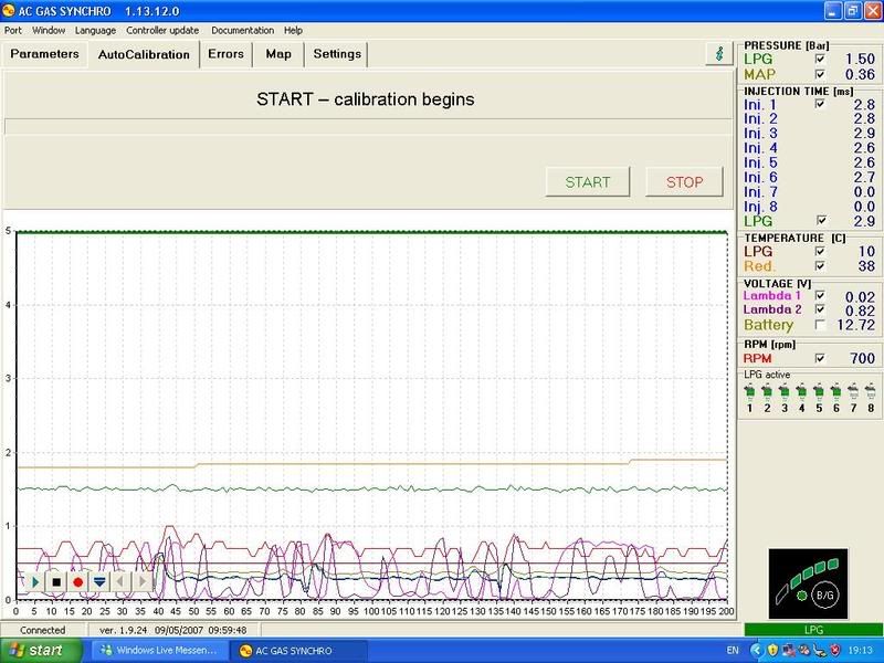

Actually, just thought. Can you get the screen up on the LPG software where there's an "oscilloscope" display of all the parameters, wait for it to falter and then capture the screen then post it?
I'll do it asap :y

I have the screen dump, will post up in a mo

Screen shot of graph, just after the blip:

Hmm. Damn jpeg has fubar'ed the colours >:(
I think the RPM line is wandering between about 1000 and 400 RPM. Uncommanded, I take it?
LPG pressure looks stable throughout so the evaporator seems in the clear. LPG injector duration seems to follow petrol injector duration which isn't exactly stable - cause or effect? :-/
Lambda sensors are cycling, a little unstable but, again, difficult to tell if that's because the ECU is trying to adjust idle or because the fuel is all over the place.
It's really difficult to see how a few degrees of air temperature could make a difference. Correction required due to air density would easily be taken out by the Lambda correction even if the IAT wasn't doing its' job.
I'd go with the dodgy fuel theory I think.

That graph was after about 15 mins of running on a cold day, with no input from me. It was just left to it's own "idle" devices...

« Reply #44 on: 23 December 2007, 01:44:21 »
Totally - this is the hunting...
