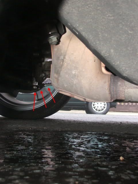

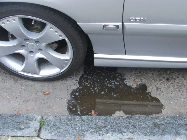

Check coolant came on last nit on the MID, so about half hour ago checked the tank and it was empty, nipped down to the garage and bought some Comma coolant to top it up with, topped it up to the level, I have just been for a short run up to peckham, less than 2 mile round trip, now got steam coming from the engine bay, looks like something is leaked from underneath the engine but can't see where it is coming from.
Find it unusual that after getting it back after lamda's getting done yesterday I have no coolant left :-/
Could there be an air lock in the system???
Some pics:

I'm gonna post some pics up in a minute, just had the engine running, it does'nt look good. Just wondering if those idiots round the corner done soething to it yesterday whilst doing the lamda's either that or just bad luck >:(

Posted up some pics, what's the HBV?, how big a job is that?
