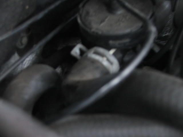

Job done, bl**dy pain getting the scuttles back on, well the larger one anyway, yes it is the HBV pissing out, now how the h*ll does anyone manage to change one of them ::)
just below that big clip, could'nt feel any problems with the hoses or connections:
