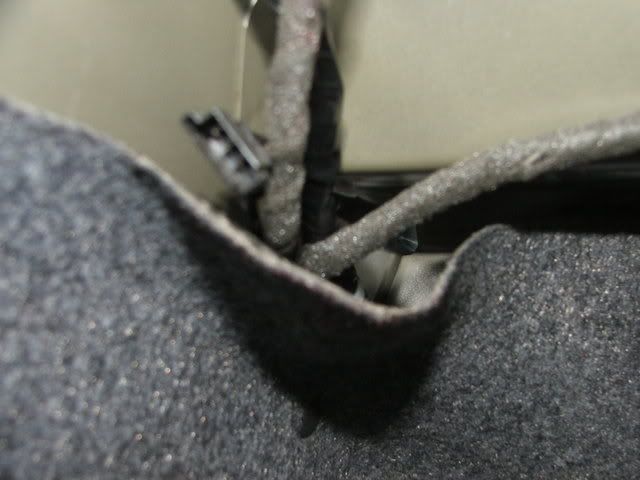

They are very slightly different.....on the facelift, the connector is 3 pin and includes a 0V connection....on the earlier ones they are two pin and the 0V is obtained from one of the mounting points............easy enough to sort.

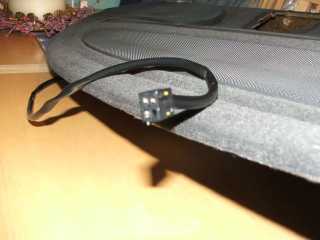

OK then how do I sort it then get another connector for the blind or replace the one in the car?, can the bit be bought from Vx or try stealers?
The sun blind connector:
The connector in car:

cut both plugs off ands join wires mike !! should be same coulors  :-?

Was wondering about that, better nip up hellfrauds and get some connectors or crimps..........rear blind is a pain to get out, are they stuck with any glue?

Well I appreciate that :y, I tried pulling and wangling it etc., still no joy, it's all back now, so will probably do it weekend now and take both C-Pillars out this time, I'll connect the wiring and test the blind works before I take all the bits out again and fit it :y

 no worries !! it defanitly works ok bud just need to connect the wires in the right order !! ;D
