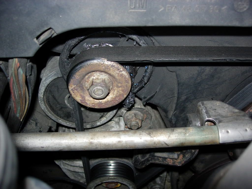

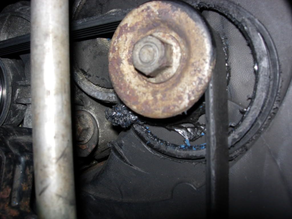

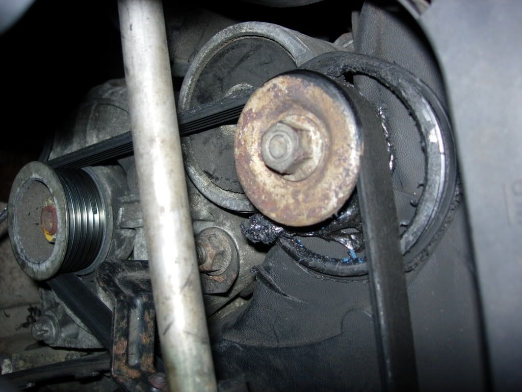

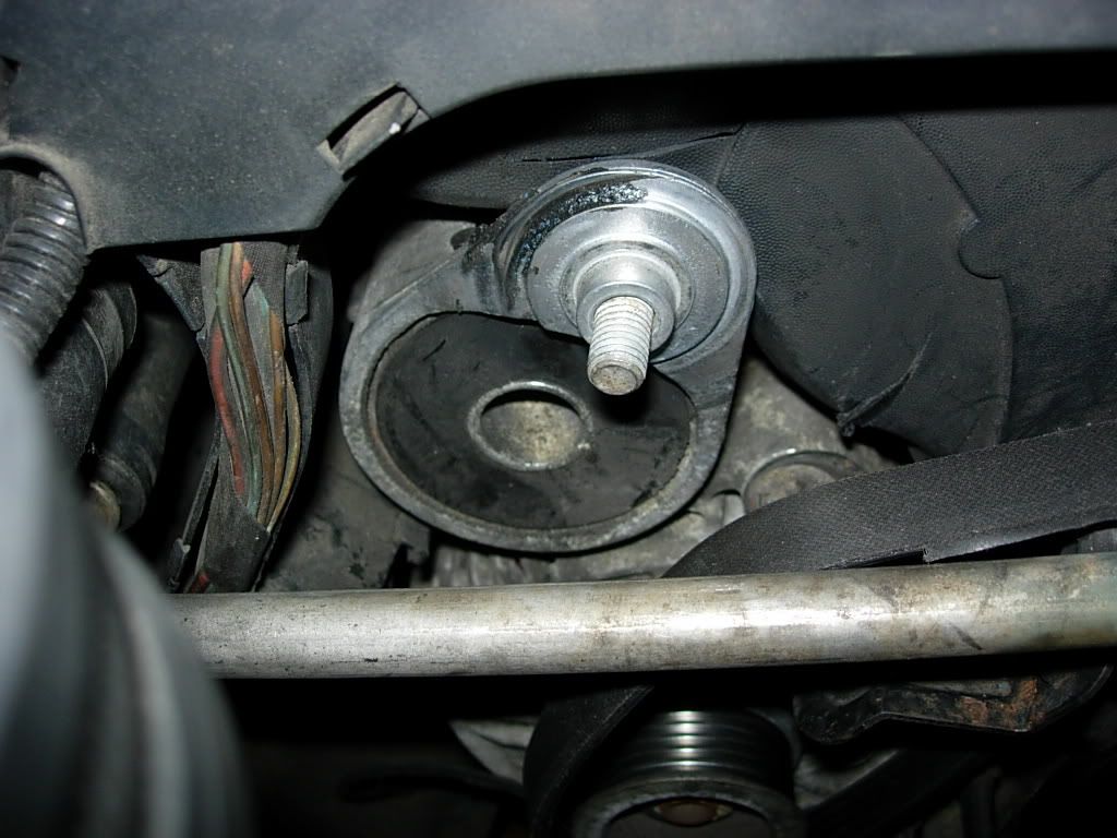

OK guys I am now in need of some serious help :(  I have just taken the car for a spin and got back and now this has happened....
It has taken the edge off the belt but it seems like the tensioner has failed....  I hope this is an easy fix as I need the car for work on Tuesday and have no other transport  :(  Can anyone give me some advice on what to do next?  And if anyone local to me (South Notts)  with parts I could buy off you I can come and collect anytime.

Re: Another battery thread + bonnet struts
« Reply #10 on: 30 March 2008, 16:57:04 »
If its just the tensioner pulley its a 5 minute job for that .. but the belt as well takes longer obviously.
The pulley on its own is part number 9157962 and is £23.05 retail or £20.75 with TC ( + VAT of course).
I did the pulley in a field last weekend ... but didn't have to do the belt .. :)
There's a thread somewhere that tells you how to do the belt as well .. involves undoing a few more bits to gain access if memeory serves .. :(
« Last Edit: 30 March 2008, 16:58:12 by entwood »
RichB
  • Loughborough
  • Posts: 156
« Reply #11 on: 30 March 2008, 17:00:38 »

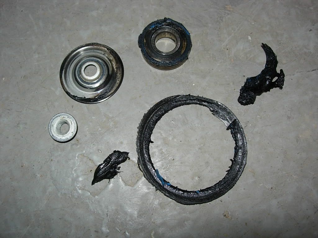

Shall I take the pulley off and see whats happening beihind it?  I am a bit scared because of alll the black gooey stuff that is behind it, what is all that stuff?
« Reply #12 on: 30 March 2008, 17:07:19 »
Yes, I would take the pully off its a 2 minute job. then you can see what is going on.. it might be you need to replace the whole tensioner unit, not just the pulley.
The gooey stuff is either the belt or maybe something's got caught behind the pulley ??
I would also be  taking off the old belt .. it needs replacing and it will save you time by learning how it comes off now .. rather than rushing once you get the bits ....

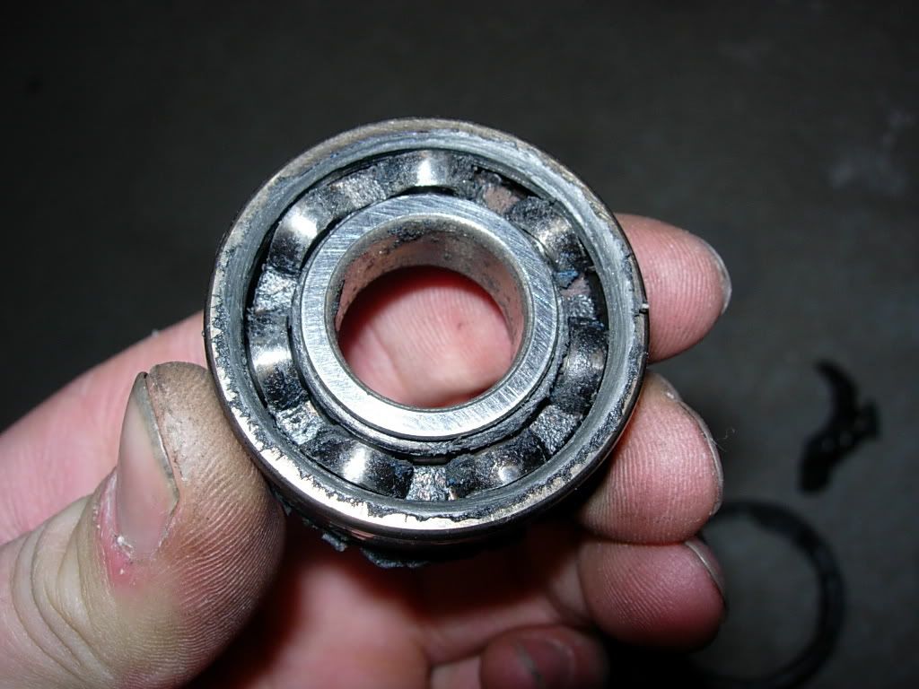

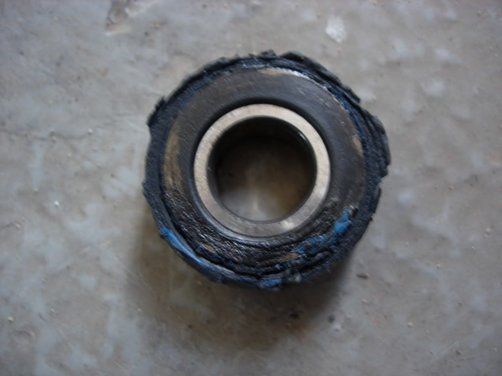

RichB
  • Loughborough
  • Posts: 156
« Reply #13 on: 30 March 2008, 18:31:58 »
Right I took the pully off and it is well knackered.  It hardly moves at all and the tensioner doesnt move at all, so I guess thats knackered too.  It shows in the Haynes manual that it should move to tension the belt but it doesnt budge!  So I will be off to Vauxhall tomorrow to see if they have got these parts in stock, I hope so!
Any tips on replacing the tensioner?  I assume you just have to take out the 2 bolts going into the block from the drivers side as shown in the second pic?
Some pics of the damage...
