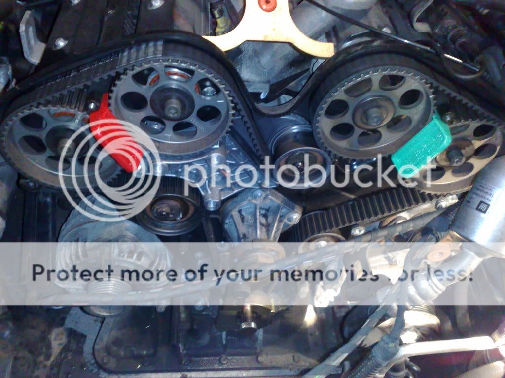

pic of cam belt so you can see what everyone is on about.
 4 cam wheels at the top, smaller adjustable idler in between cam wheels 2 and 3 (the one they are talking about) with torx bolt,torque to 40nm.
the tensioner on the left under cam wheel 1 with nut on smaller stud to adjust, 20nm.
Bottom idler lower right, not adjustable, also 40nm.

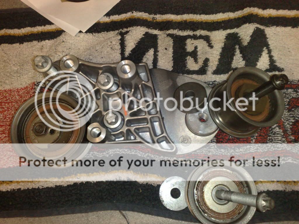

ok just re read and i just twigged, the only idler that bolts into the engine is the bottom non adjustable one. the idler ,top midlle in previous pic, bolts into a backing plate that carrys the adjustable idler, on the right in this pic, and the tensioner on the left. if they used a cam belt kit for your car, all they do is swap the backing plate with rollers attached.
So, from your post it sounds like the bottom non adjustable pulley bolt has failed...? But that does not bolt into the cylinder head...
