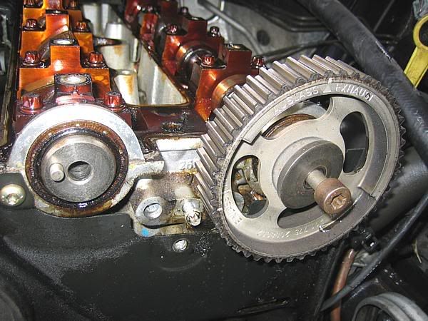

Actually I'm not even sure the oil leak was down to the seal, have a look at the pic below, doesn't look right to me at 4 and 9 oclock.......

I thought that my front end oil leak was down to the crankshaft seal, but it turned out ok. (Changed it anyway). However BOTH camshaft seals were very badly decayed and oil was pouring down from the top.  You might do well to check these - don't want oil seeping all over you nice new cambelt!
