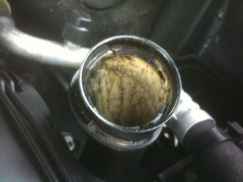

My dad does regular short runs and there is always mayo in the filler..... like this:
I nearly crapped myself when I saw this first time.... but 3 months on and all is well, no coolant loss etc...
Wouldn't worry about HGF unless you notice that it's significantly going through coolant (or oil in the most extreme of cases).  :y

Thanks for the piccy...
Mine is definately less than that....
I've given my filler cap another wipe over and I will check it tomorrow when I get to work at 1500...
