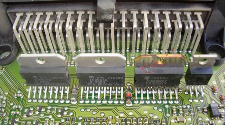

and in pic looks as there is a crack or chip in the of center left part of the chip.
Ali Ch

the bottom is nice.....so as the lid......it was covered with a small plastic cup (four of them) and a clip so as to be firmly attached to the metal body of the casing to act as heat sink (which i removed to check them)....the plastic cover was ok too

was meaing this.

yes....that what i first noticed...some times ICs do have such cracks when they come out of the factory, it would be only in its plastic case not in the chip inside....but if it was originally ok then this is due to over heating......i think i have to fetch some ecu and test it in my car before i attempt buying one.
now i have to look for a donator tomorrow  :-/

gm dont do damaged chips in there stocks every iterm is checked, if there is a crack in a chip they dont last more than a year, have a few ecus here at home and none have any chips or cracks in any thing, would say that is the fault, air is getting it to the chip backerlight case when it crack make the micro wires move or snap.

That IC has at least been overheated. I don't know if it's due to lack of cooling or internal failure, but I would definitely change that IC or even the whole ECU.
That IC is an "Octal intelligent power switch with serial input". Datasheet: http://www.digchip.com/datasheets/parts/datasheet/477/TPIC2802-pdf.php
I don't have schematics for that ECU, but I reckon some malfunctions in that driver could cause all sorts of engine management problems.

and the pic in a previous reply is why i am trying another ecu, there is a good chance that two of the ICs is malfunctioning, the small ic has a similar but much smaller defect.
