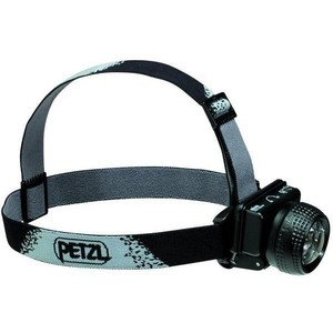

 and I managed to do it in the dark with a mini mag light in my mouth.
Oh how I enjoyed it
You want one of these then!  ;) You look like a miner but they give you the use of both hands with the dental bill.  :y
