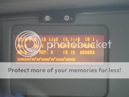

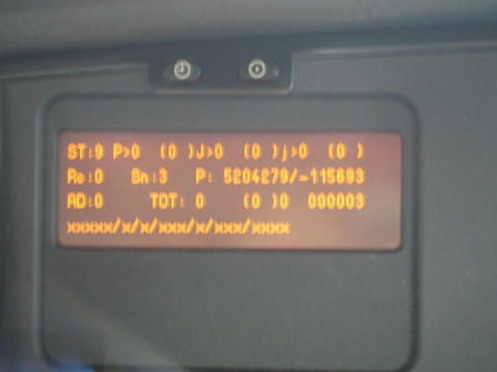

Work this lot out then...  ...I have included tractor (GID) ones, as I get a TMC logo on the display on that one...
Re: ncd* service menus with tmc message counter
« Reply #5 on: 08 February 2009, 18:52:30 »
tractor has 3
cid has 04014 :-/
  • Posts: 108236
« Reply #6 on: 08 February 2009, 21:54:41 »
Just put CID in tractor, now get a TMC icon - this was masked by the Telematics line before.
« Reply #9 on: 08 February 2009, 22:59:56 »
cant get the link to your pic to work Jamie, can you see whats wrong with it? its the second pic down in your list of cid pics ;)
basically im thinking navi menu 2 is the tmc page, and the 3rd line down being relevent with the counter on the end from(0) onwards.
presume the xxxx' s mean nothing present?????...and mine has no chance :-?
