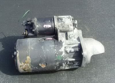

No, 4 studs on the starter solenoid, 2 big, 2 little.
4 wires, 2 big, 2 little
The big battery feed goes to the top big stud, I have forgotton where the other one goes (but that has a big wire going from that into the actual starter)
The 2 smaller connections cant get confused as ones 8mm and the other 10mm :) (although they seem to join).
I gather the starter earths through the body? As I said its starts/turns over fine, the engine does do a couple of 'skips' initially when running, but fine after 30secs or so...
  • Posts: 108345
Re: super urgent! Changed the starter, now wont charge
« Reply #12 on: 24 July 2009, 16:06:07 »
No, the big wire from alternator has to go to same stud as wire from battery - basically, the idea is its a single wire from alterntor back to battery, but shares starters wire from starter to battery.

Ummm... so ignore the lower big stud and put them both on the same one? Its on how the previous one was :)

« Reply #14 on: 24 July 2009, 17:18:08 »
generic pic of starter...
what I have (from memory)
