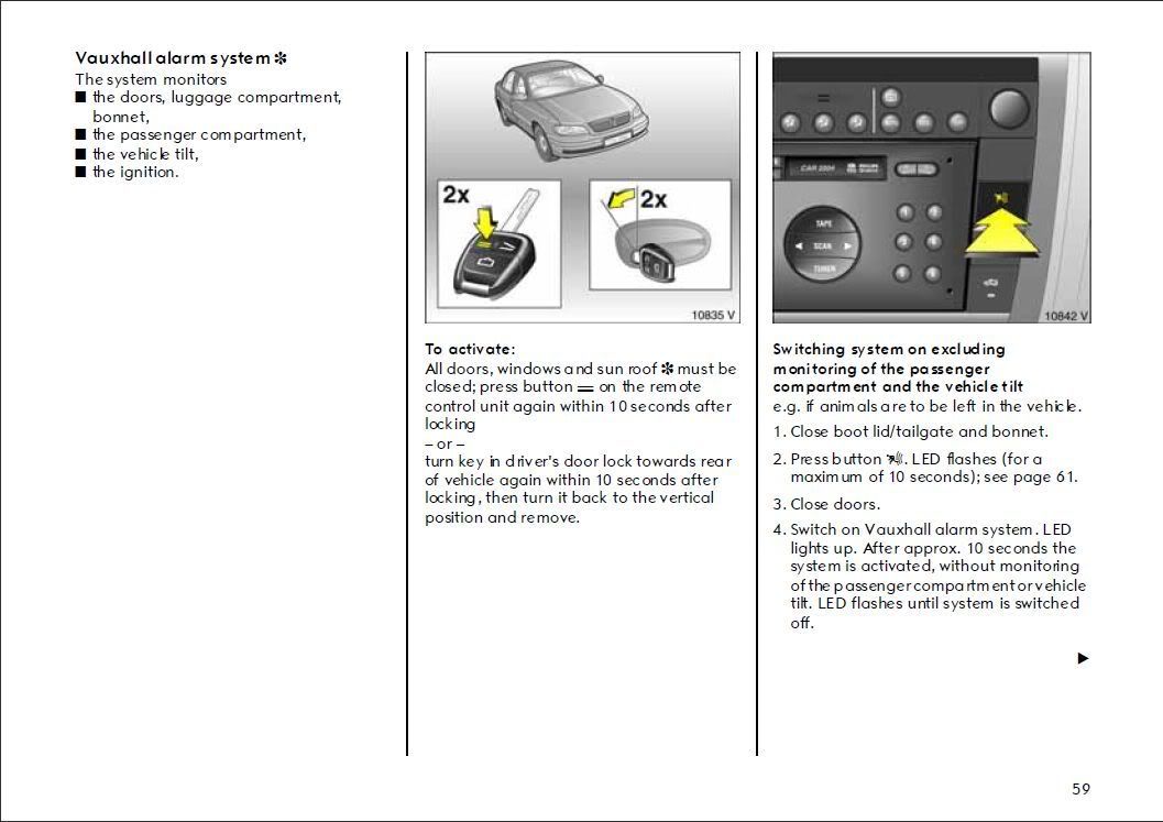

Its not a panic button mate. It disables the alarm sensors which are in the car.
If you lock someone in the car and they DONT press the button - the alarm WILL go off if they move.
Likewise, If you lock someone in the car and the DO press the button - the alarm WONT go off if they move.
You need to press the button before locking the car though. :y

then why dose it say in book panic button, pic with man running off, say alarm gose off for 20seconds to deter entry. oh and alarm is set for dogs in back, any movment dont trig alarm checks before arming,
It doesn't, the owners manual refers to it as "Vauxhall Alarm System"
that maybe on your book but not on my book, car was set for having dogs in back, have never had to press button to deactivate the sensors do's it its self dose 2 beeps when dogs in car and none when they are not.

Omegas never had panic mode, as Ian says its to disable the alarm sensors, and i have never seen it refered to as panic mode.

Not sure if this applies to Omega, but most Sigma alarms do actually have a panic facility if the key is pressed for around 5 seconds continously.
Howver, no such thing as a dog setting - I`m guessing you mean interior sensors deactivated or desensitised ?

The Omega button on the dash simply disables the sensors - which is what the fiddly old press button on the Cavalier Mk3 above the drivers seatbelt on the B pillar used to do.
It's there so that you can leave the sunroof or a window cracked open or dogs etc in the back without the alarm going off.
Rusty - can you show where is says that as I previously had '94, '95 & '96 Omegas from new and it was as I've described above. Now I've come back to a '98 its exactly as I recall.

I've got most user manuals here, all describe the operation the same - its to disable ultrasonic sensors, leaving just a perimetric system active

I have a 94 manual, which covers 94/95 cars which use the same system...
