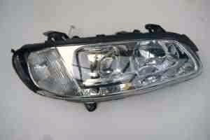

I've been trawling e-bay for a pair of reasonably priced non-HID headlights for my F/lift Mig. My mate runs a breakers and said he's sure he had a brand new pair in stock. I called over today and yep, brand new, still in the box with the cellophane wrapping untouched and even better, as they had been ordered in for someone that never came to collect, I could have them for cost price. Brand new pair for £126.50  :y ...then I noticed the words Xenon on the box  :(  I need the standard jobbies.

Tried a H1 bulb and it seemed to fit but then it dawned on me...no wiring on that side. HID wiring runs from the ballast pack.
What I do have is a spare set of Hella std h/lights that I have dismantled with the intention of fixing the adjusters, but they are totaly fubar.
I was wondering whether the Hella H1 projector unit  would swap over with the Depo jobbies.
Anyone know ?
For the wiring it's just a case of swapping that over as well.
« Last Edit: 26 November 2009, 13:26:46 by Turk »

So far so good. The projector unit are compatible.
All I now have to do is swap over the wiring...and that's where I've hit a wall.
How do I remove the round socket in the back of the unit. It is loose when the wiring is wiggled, but just won't come out.
Any ideas ?

Right, finished at last. Wiring loom sockets can be removed by using something slightly smaller than the I.D of the socket housing as a drift and tapping them out gently and when the won't move any further, one slighty firmer tap and out they come. Refitting is a push-fit.
Anyhoo, finished the conversion, will  probably fit to car on Sunday.
