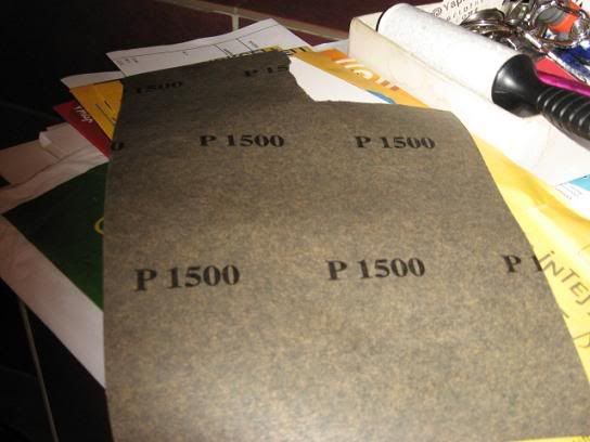

for cleaning scratches..
if the scratched area have original paint or newly painted
examine the scratch if its less than 1/3 mm deep..You have a chance..
otherwise you wil go down to color paint layer and after will you need
a respray what means trouble..
first use 1500 grid sandpaper on the scratch vertical to the scratch
direction with enough water (before keep a small sandpaper in water
for few minutes to be soft enough)
than use it in the same direction just for half a minute not more..
then cut small portion is enough like in the pic.
after you need G3 or similiar (most small grained paste)
and a machine like this with variable speeds..
before using the paste apply small amounts of water on the sponge..
when the area is enough shiny use much fine grained sponge head with color polish..

Aha... knew this had been talked about recently... http://www.omegaowners.com/forum/YaBB.pl?num=1202845817/0
Re: look what i did today.......
« Reply #25 on: 23 February 2008, 20:01:18 »
Cheers cem...... some of them are quite deep..... now i am pi**ed should have got the bl00dy kids parents to pay for the damage.  >:( >:(
bad..
there are places expert for those deep scratches , using special methods for localized paint ..(here can be done from insurance like windscreen but one time a year , sure theres some similiar ways)

looks great ! well done you ! if you're bored i've got a jag here with half the crap off  the m6 all over it................ ;D , as far as your scratches go as long as they're not too deep, hire a mop for a weekend and buy a litre of farecla g3, works wonders on minor scratches and if you think its smooth now..................! stick with maguires polises, i do a lot of valeting for main dealers and you cant beat it, it really is the best !
« Reply #28 on: 23 February 2008, 20:33:18 »
g3 only takes the scratches but not a perfect polish..You need to use cream style polishes to get a very clean and shiny surface ..
maquires is not sold here so dont have idea about that..
