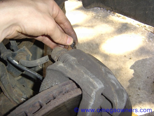

Now move on to the front drivers side of the car, remove the wheel, you should see something like this:
The bleed nipple cover looks a little different, but pop this off.
With the pipe on...
Again attach the pipe, and repeat the procedure of 'PRESS' & 'RELEASE' until the new fluid comes though.
