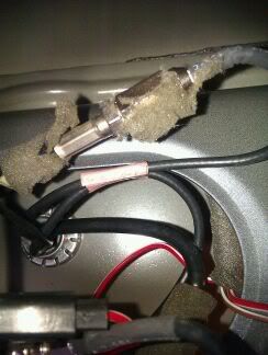

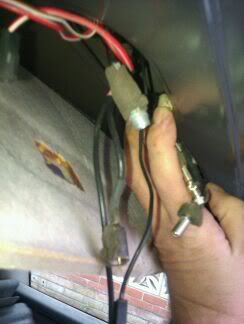

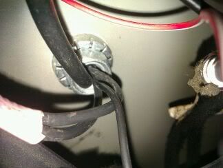

twiglet
  • Norwich, Norfolk
  • Posts: 2171
Re: Sat/nav not working
« Reply #13 on: 11 November 2011, 08:56:48 »
So it does not connect into the blue connection like on the 02-03 cars then, still have to fit the one i got off you to the car ::)
For reference, I have attached a couple of pictures showing the connectors on this base...
« Reply #14 on: 11 November 2011, 09:37:58 »
Just like the Met put onto mine but i did not have the sat nav base fitted, had to run another loom to get the correct blue connector back (for 02-03 cars) now i just have to fit the base, but as said i just use a £5 gismo that just plugs into the back of the HU and wire goes up to N/S dash and all works fine
