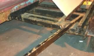

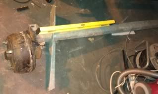

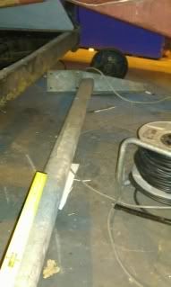

Right some pics:
This is where I want it attaching
The axle is upside down right now
Closeup of the fixings which I.suppose I could chop off and move?
  • Posts: 36539
Re: Trailer axle technical question - Not licenses or legality
« Reply #12 on: 22 December 2011, 14:24:52 »
I would have thought it ought to be possible to do a cut and shut on that.
If the welding is done competently it won't be any weaker, and most of the loads are from the mounting points down to the wheels. Axle is just there to keep it all aligned.

« Reply #13 on: 22 December 2011, 19:51:03 »
What I would do is put the axle in place as it is then centre/square it off then mark where it is sitting - take off again then cut axle to desired size.
When welding back on get a peice of 1/8th gauge steel plate and form a plate that sits over the chassis weld it on first then weld on the axle thus giving it a lot more support.
My idea is somthing similar to the backing plates that you get for indespension suspension units.
As for weights unless it's got a plate on the chassis of it your ok. :y
« Reply #14 on: 23 December 2011, 00:52:24 »
I do know a guy who will chop anything to bits to make it fit anything if that's what you want M, but if I were you I'd take option B for this particular scenario (much cheaper, and easily do-able at home).
