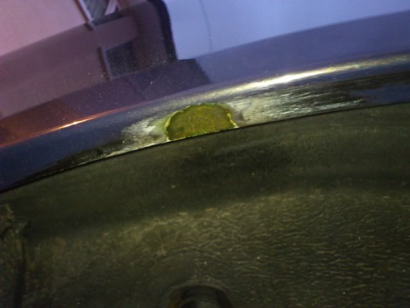

Imo if it on the underside of the arch you can sort it easily yourself.After last winter the paint on the underside lip of both my rear arches had flaked and blistered. I cleaned of the loose paint etc. treated with rust neutraliser (Bilthamber is best although expensive), then carefully masked the area and sprayed the underside lip part with gravigaurd.Its the type of slightly crinkled finish you sometimes see on sills etc. to protect paint from chipping.Then sprayed original colour and lacquer on top of that. Peel the edge of masking tape back slightly to prevent an obvious step from forming.Taking your time and being patient is the key to a good finish.
I was well pleased with the finished job on mine and I dont expect any further problems as the gravigaurd will stop chipping/ flaking of paint which is where the rust would probably start. :y
You will need to scrape the paint off where the rust is then sand the rust away as much as possible,then proceed as described earlier Dan.Painting rust killer on top of the paint wont kill the rust. My method is similar to Geoaffs other than using graviguard (which you paint the original colour over the top of) rather than hammerite.
It hasnt blistered the paint though albert. Would i stil be able to use the rust treatment as it isnt visible?. It is on the underside :)

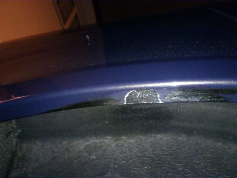

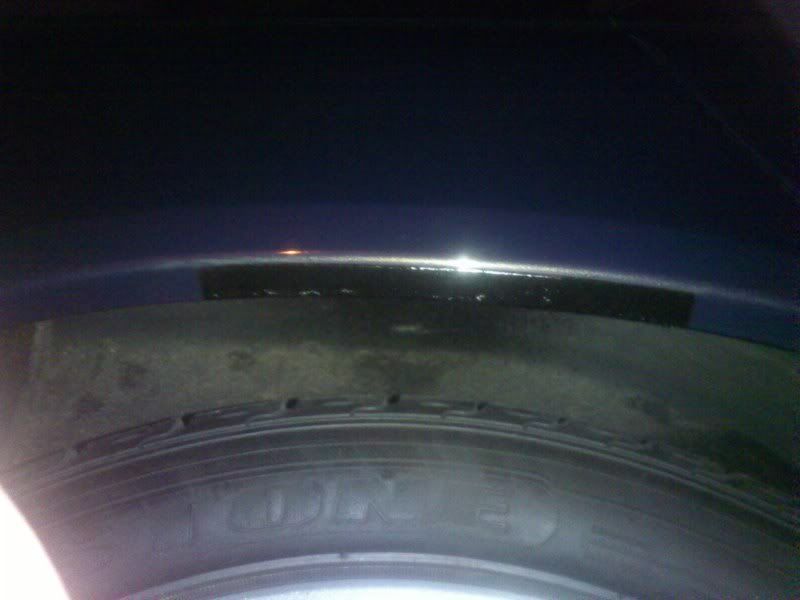

Started the rust removal today. sanded down the area on both sides with a medium grade sanding block and small wire brush. Did the inner edge of the arch aswell until i broke the blister and removed most of the rust. To be fair to the car where wasnt alot at all. Applied Kurust and then re applied another 2 times.
Next is to sand off the Kurust and primed ready for paint followed by underseal.

« Reply #27 on: 08 January 2012, 18:44:25 »

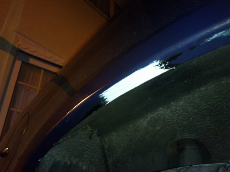

Kurust did the job well. you can clearly see the difference. Back to a nice smooth metal surface. Had to clean the Kurust soloution off and sand it some more.
Then added the primer to give as smooth finish as possible. Will give it another coat in the morning.
The black marks are just a little left over underseal.

FURTHER UPDATE.

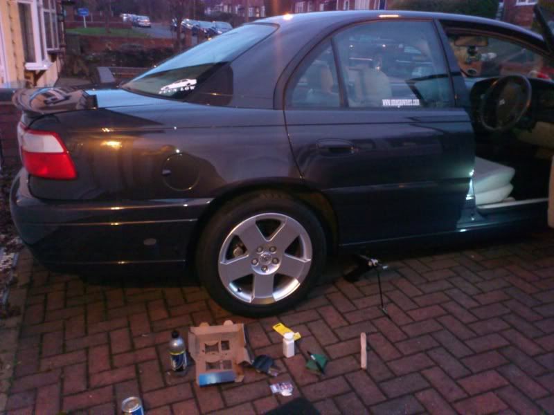

Well i think ive done an ok job.
After the filler dried i filled it again, waited to dry. Applied a spray of paint and then laquer , again when dry i applied alot of underseal to the inside of the arch as well as to the work i had done on the underside of the arch. may seem pointless painting it but thats just me.
Few finished pics, excusing my ugly mush ;D
I need to give it another coat of underseal when its dried and then we shall see in the coming months or hopefully years how good of a job i did ;)
