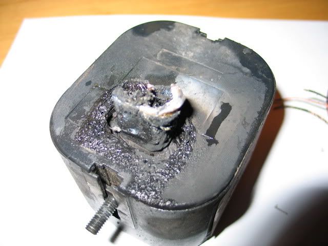

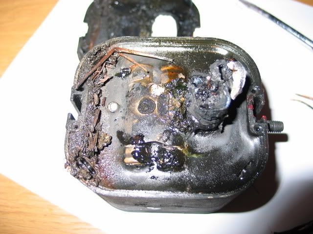

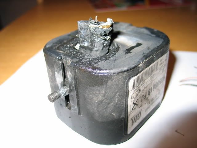

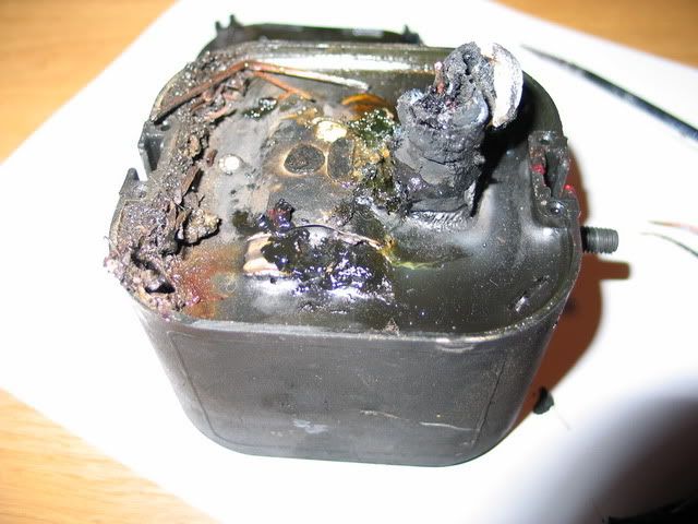

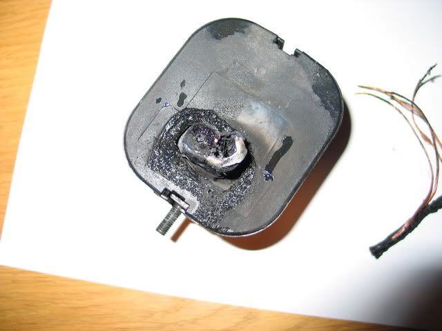

My car has nearly gone up in smoke!!!!
We heard a strange noise coming from outside, went out to investigate and found it to be a very poorly sounding alarm noise from my car!!!
Lifted the bonnet to disconnect the power sounder and was greeted by smoke, shortly followed by flames!!!
Fire brigade called out by which time Jimbob had put the fire out and worked out that the power sounder batteries had failed and leaked acid, hence fire!
The car hadn't been driven for 24 hours! Scary that something like that could happen to a cold car!! Thankfully I wasnt out with the kids in at as happens daily!!
Fire brigade arrived and checked the car over, filled in their report and left!
Jimbob now surveying damage, how scared were we, the car was inches from the front door!

Power sounder is a useless piece of kit. I disconnected it on both of my omegas.
  • Posts: 36512
Re: Spontaneous combustion!!!
« Reply #6 on: 28 November 2009, 19:19:51 »
I've suspected the power sounder to be the cause when I've seen reports of fires in this area in the past.  :(
The permanent feed is fused only by an 80 amp fusible link, IIRC, - yet the wire in the loom I wouldn't trust with over 5 amps.
I would advise anyone with a power sounder over 5 years old in their car to either remove it, replace it, replace the batteries in it or fit some inline fuse holders.

So yes...sat watching starwars when we hear the strangled yelp of a car screaming for help.
Open and start it to try and turn off the alarm.....then see the smoke.
pop the bonnet....lots of smoke, and some little flames....SHIIIIIIITE
Ljay ran in to keep the kids out the way, and call the fire dept out.
I scratch my head for 10 seconds, and grabbed the hose and managed to put it out & Disconnect the battery.
Had the scuttle off by the time the fire crew arrived who checked it was out, and did a little report.
I finished dismantling it all, and made the wires safe, not winning dismantling the sounder....all sealed....any clues?
As has been said, lucky we were there to sort it!
So my advice to you all....is disconnect those sounders, I personally don't want something that can go up in flames like that connected to the car!  There is enough neccessary things, without a dodgy alarm siren.
