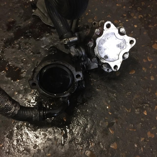

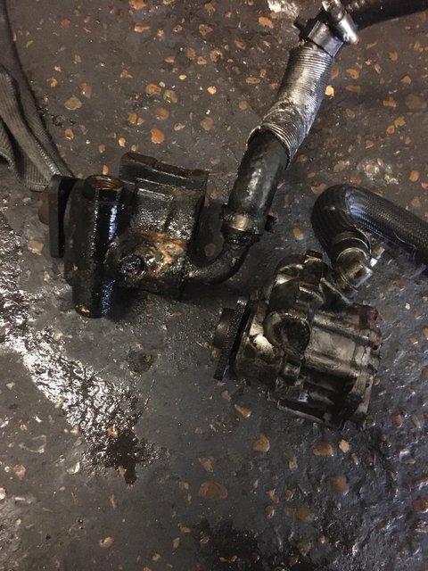

 Okay, I supplied a pump to a member which I had in stock, for a 3.2. just had picture, pump supplied is different to the one said member has, I think his pump is 3.0L pump, I will be giving the member a full refund... Picture below, supplied pump is the clean one. Any one identify ???

 From what I can remember, the fitting which goes into the pump is different, .
But I cannot understand why a 3.2 would have a what looks like a 3.0L pump, unless previous owner did modify the fittings..

« Reply #6 on: 10 August 2020, 09:30:24 »
I recall the pump change did not align to the engine change year, so there was probably a short period where the 3.2 had the old pump, is it an early 2002 car?

« Reply #7 on: 10 August 2020, 10:45:14 »
 I don't know what year the car is,
As I said it does look like it has the earlier pump fitted, looking at the picture, just trying to make it easier for the member to get the correct pump,

« Reply #8 on: 10 August 2020, 10:56:25 »
Its definitely the earlier pump they have, the round rear disc with circlip is the give away  :y

Re: Spot difference,,, Pas pumps
« Reply #9 on: 10 August 2020, 10:59:53 »
 That's great Thanks,, :yso he needs a 2.5/3.0L pump.  I will message him the news..
