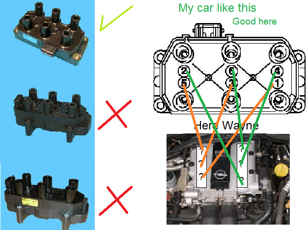

Yes, this is what I want, thank you all
See the picture
Like this image

« Reply #6 on: 10 December 2013, 18:55:34 »
Did not work the way   :(
Please Help

Re: ignition coil omega v6
« Reply #7 on: 10 December 2013, 19:10:27 »
Please Help
You've mixed them up. That is the definite way they go  :y

« Reply #8 on: 11 December 2013, 19:39:22 »
Please clarify
Webby the Bear
  • Northampton
  • Posts: 12763
    • 2000 (W Reg.) 2.5 V6 CD
« Reply #9 on: 11 December 2013, 21:10:38 »
Please clarify
          Windscreen
5                              6
3                              4
1                              2
           Radiator
« Reply #10 on: 11 December 2013, 21:18:47 »
Webby the Bear
  • Northampton
  • Posts: 12763
« Reply #11 on: 11 December 2013, 23:49:09 »
For a moment there Rob I thought those lines were you crossing that bit out  ;D
