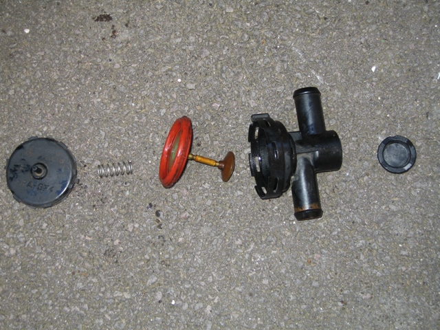

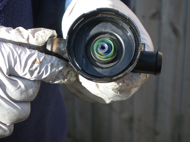

Tractor's HBV changed, took all of about 5mins - so much easier than V6.
Failure was in blue seal - not clear, but split on left side of blue bit
