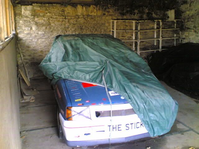

If you havent noticed the main reason i bought mine was to tow my track car around.
So here is a few pics of my old girl and her new mate.
Hope you enjoy.

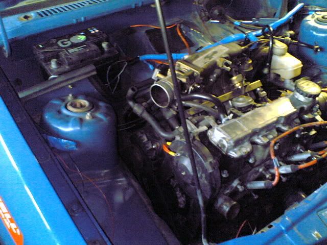

First on the list today was to finish the prep work in the engine bay ready for me Dad to weld on sunday yay.
Had a poke around and found only 1 little hole in the engine bay by the passenger side turet.
Not bad for a 17year old car.

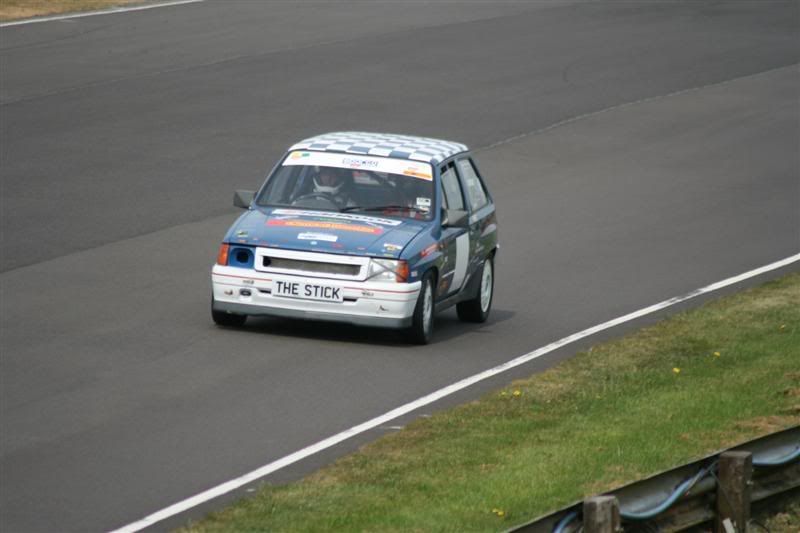

Back on the deck and lower at the front now. Must sort that out.
Once back on the floor i did what lee has done and removed a head light thats right with the hammer.
Click on the link to see it run for the first time

On the Nova there are a few joins around the engine bay you weld to accomodate teh extra torque of the bigger power plant and reduce twist a little......and you dont seem weld them (and the pics show this), you stitch weld them.
Interestingly, the slam panel on a Nova is a structural member.....and I'm not convinced that the replacement bar is going to give quite the same level of support and certianly not with a single vertical bolt....it wants a horizontal one to at least.
With all the weilding done to the engine bay it is stronger than it was in the first place.
I wouldnt of cut it out if it hadnt of been weilded.
it still has the bottom part which is well done and yes my typo error it's been stiched not seam and the rear of the shell is going to be done over next year as having to much fun at the mo.
