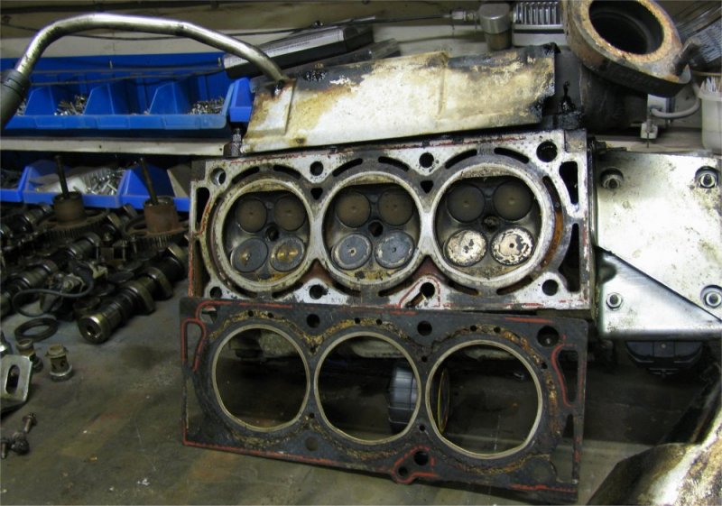

Another pic - this time of the underside of the head & gasket, showing a good seal between the cylinders and the coolant chambers, with typical corrosion taking place in the 'less than critical' areas.
The inlet valves on pot 6 look to be a lot cleaner than on 2 & 4, anyone got any suggestions as to why?

I dont, but whenever I see pics like these I realise how clean my old heads were!

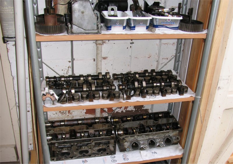

Here's a pic of the heads and cams etc, all awaiting cleaning and refurbishing - that should keep me busy in the workshop for a while!

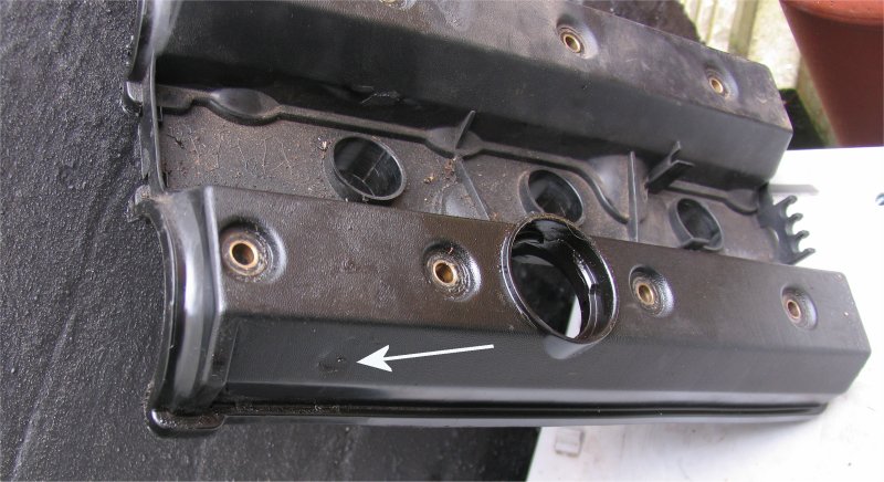

Another pic showing the N/S cam cover. It looks like oil has been seeping out of a crack - presumed damaged a while ago, and no doubt contributing to the plumes of smoke that would appear from under the bonnet after being worked hard. I'll be on the lookout for a replacement, and the mating face looks a bit too wavy for my liking, so anyone dismantling a V6 2.5 engine please let me know.

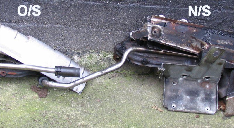

An interesting picture showing the difference between the O/S and N/S exhaust manifolds and sheilds. Despite the oil stained and burnt N/S, the car wasn't using much oil - maybe an egg cup full every 500 miles. Hardly any smoke when stopped, if car was being driven with economy in mind. I knew the cam cover gaskets needed to be done, so good job the head problem came along before I'd done the job.
