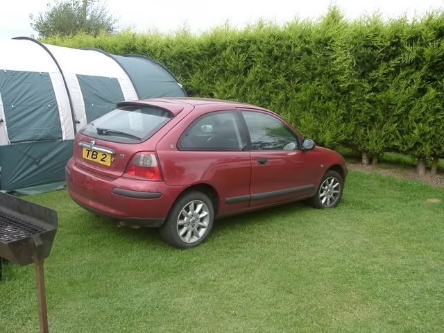

I thought this was TB2
No, thats the rather nice Thrashmobile...  ...an excellent little motor.
